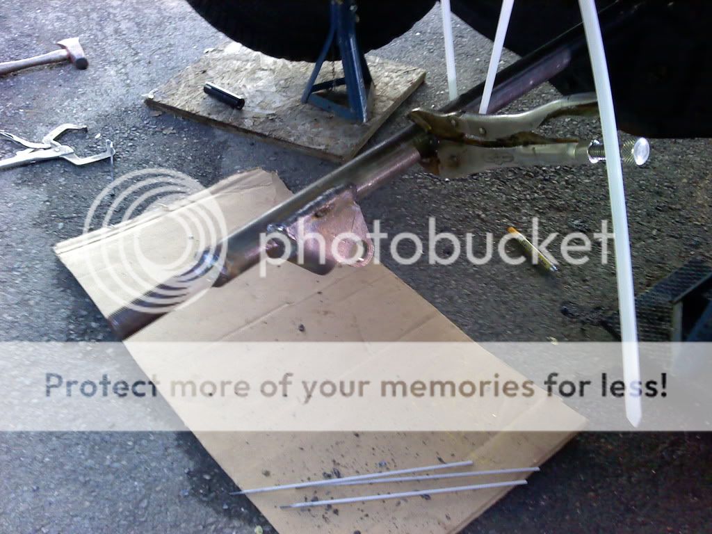

Oh I know. I didnt spend all this money, to just throw some weak welds on there. I was going to see how well mine would penetrate and how good the bead turned out.
Then it will be weaker when you try to re-weld it, there's a whole lot more force on that bracket then you think.
Tack it with yours then take it to a real welder. Seriously it will break while on the road at speed. It's not worth risking the whole truck to save an hour
Dustin, you might want to start saving your pennies for a 220 welder, your technique and welds are good, just the tool you are using needs upgrading. I'm sure you can sell your welder on here to recoup some money. Check out either Clist or Ebay to find em a little cheaper...

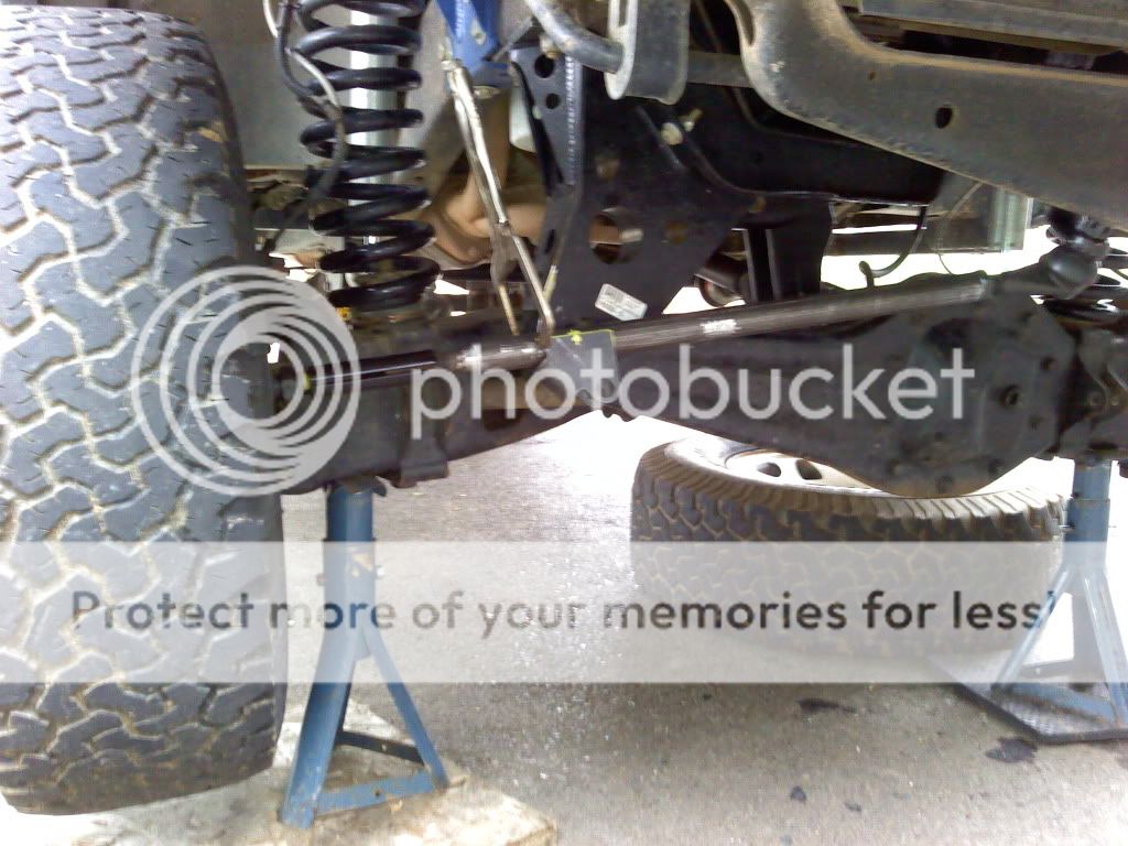

This is a mock up so I could get the bracket placement right. Going to pull it back off and weld her all up and brace, then re brace the bracket. Does the placement look good?
The jacks are causing your suspension to not sit like it should and normally does at ride height. To get a more accurate placement measurement for where to weld that bracket (this is what I should have done) I would put the tires back on, and put a plate and two steel dowels underneath one tire, so that the suspension is not fighting the ground (scrubbing) and the beams can go to their static ride height and not be jacked/angled like they are now. Once that is done, take a measure on where to place that bracket. I lined mine up so that the pivot of the draglink and the axle beam were vertically in line with each other.
Also before you weld it up, make sure the clearances are all good between the back side of the bracket and the axle drop bracket. Ask me how I know :icon_twisted: lol
