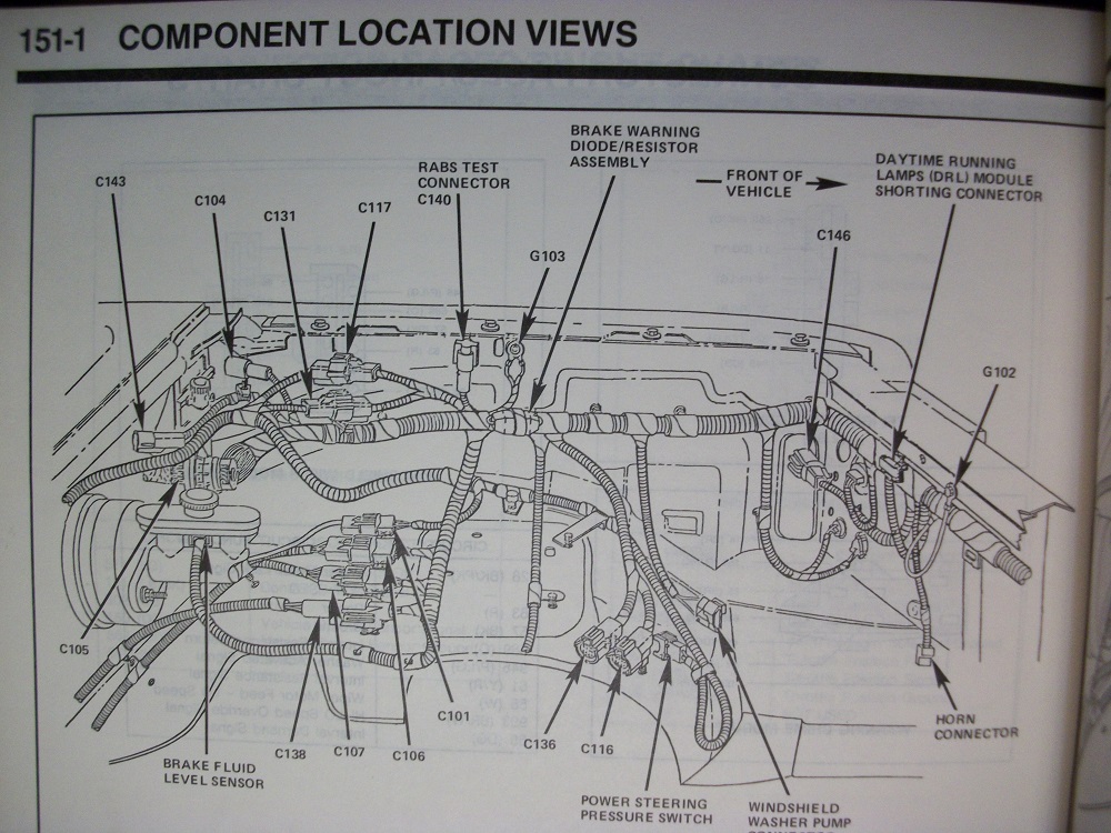

Instrument illumination grounds with G103, on the driver inner fender. See the schematic and the the G103 location drawing.

Would this explain why everything works as it should until the turn the key? and the reason why my dashboard lights cant dim?
Yes, I can see that being the case for two scenarios. Key "on", first, more stuff is powered up, and trying to ground through a flaky ground point that otherwise works OK to a point; and second, a circuit with a bad ground can find a ground path through a related non-powered circuit, but once that second circuit is powered the ground path is taken away from the first circuit. The second scenario can seen a lot in lighting systems, one symptom being bulb filaments glowing un-expectantly from the current load. Hence your description of "now my truck has daytime running lights" leads me to suspect that you may have a grounding problem.
I'm assuming that your truck is not equipped with DRL (I think that Canadian trucks were, and Ford did offer them). And ground problems are pretty common, especially as a vehicle gets some age on it.
If were me, I start with looking at the truck's grounds and work from there.
