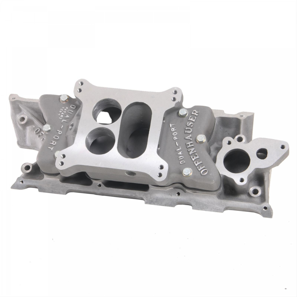

I have no idea if I would ever pursue a new intake manifold for my 2.8 in my B2, but after a little looking around today, I noticed that there are two listed on summit's site that say they will work for the 2.8 V6. They have two different model numbers too: 6097 T vs 6097 DP.
Anyone know what the difference is? Maybe I missed it on the web page, but I'm not sure I understand anything other than the larger price difference between them.

This is the bottom half
As has been stated the 6097t is top half for a 6097dp.
Back when these engines were new, Offenhauser also offered a 2 barrel intake version for them. Years ago I was searching for a 2 barrel version of the intake but had no luck. If I remember right from what I learned while researching, they offered the 6097t so that owners of the 2 barrel version could upgrade without replacing the entire intake manifold.
