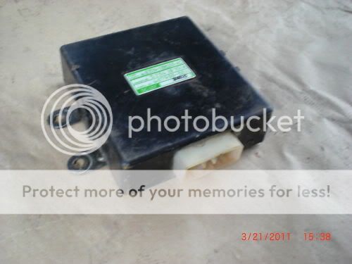

I'm trying to source a glow plug module for my '83 Ranger w/2.2L Perkins diesel, if you guys have one, know of one, come across one, etc. would you mind shooting me off a PM? it would be much appreciated.
I currently have a momentary switch wired up to heat the gp's, but would like to revert back to the factory gp controller if i can source one.
It's located inside the cab, behind the passanger side kick panel (pic below) it was used on '83-'84 diesel Rangers, the '79-'84 Mazda b2200's shared the same Perkins built diesel and gp system, the '85-'87 diesel Rangers used a 2.3L Mitsubishi turbo diesel and had a different gp system (to best of my knowledge anyway) so that gp module will not work.

With the momentary switch i'm bypassing the whole gp system and sending full battery voltage (for 6-8 seconds) to the plugs via a heavy-duty relay.
i've opened the module, it's solid state electronics i.e. non-fixable.
the module is obsolete, part #E3TZ12B533A but if you come across anything i'm all ears, thanks for your help.
