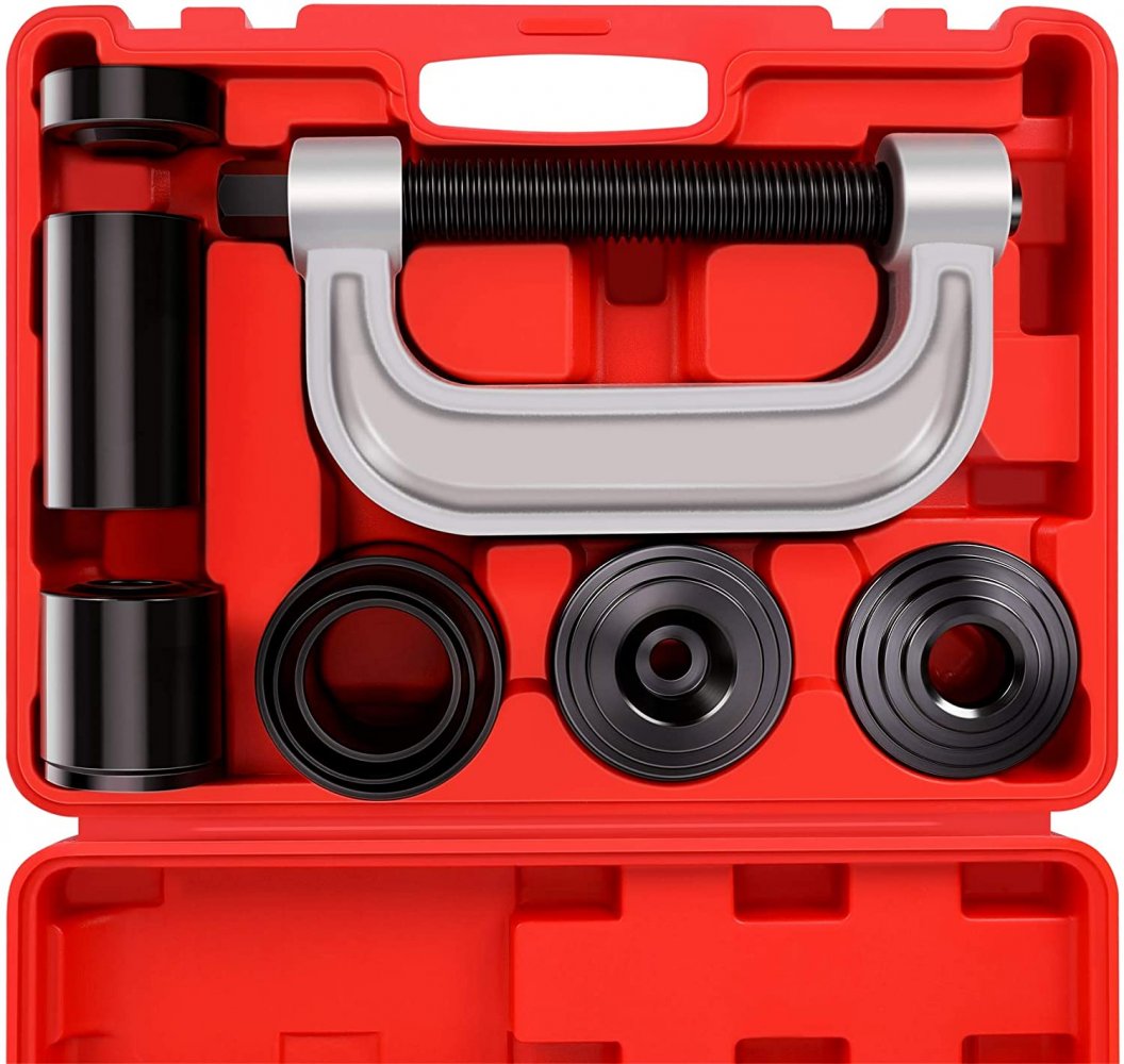

That's a great tool for tie rod ends. This is what you need for ball joints.
The above is only to press them out of the knuckle. The other tool will help bust them apart initially to be able to use the press above. Doing ball joints on one of these trucks is pretty involved and may be a little bit much for a beginner unless they watch a lot of you tube videos on it.
