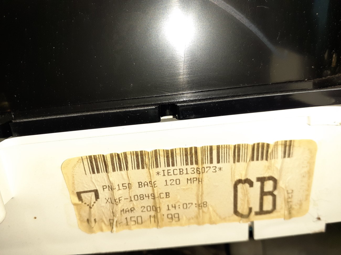

Dash Cluster w/ Tachometer Part Number?
I am also known for long winded responses at times, but this one is one that's near dumber than it should be... :). If the cluster you have has bulbs in the trans light area and 4x4 and such might as well pull those bulbs, I had to pull mine after I put it in because of an annoying theft light I think it was, maybe trans... leave the check gauges if it's there, that's your low fuel light at about 3 gallons left which is annoying and convenient at the same time (I get ~23-25mpg, freaks me out early...)
My truck is 2wd 5 spd manual so no indicators for 4x4 or auto.
I picked this cluster because it's also out of a 2wd 5 spd manual.
I won't know what indicators are different in this tach cluster until I get it, but I really hope the layout is close to mine.

The tach equipped cluster was delivered earlier today. I looked it over and it looks to be in good condition.
4 out of 6 main bulbs were blown and the other 2 were cloudy with a chance of burnout so I'll just replace them all before I put it in the truck.
All the little indicator lights look okay. I did a continuity check on 3 but it was too hard trying to hold the tiny bulbs and probe the hair sized ends with the meter so I just settled for a visual inspection.

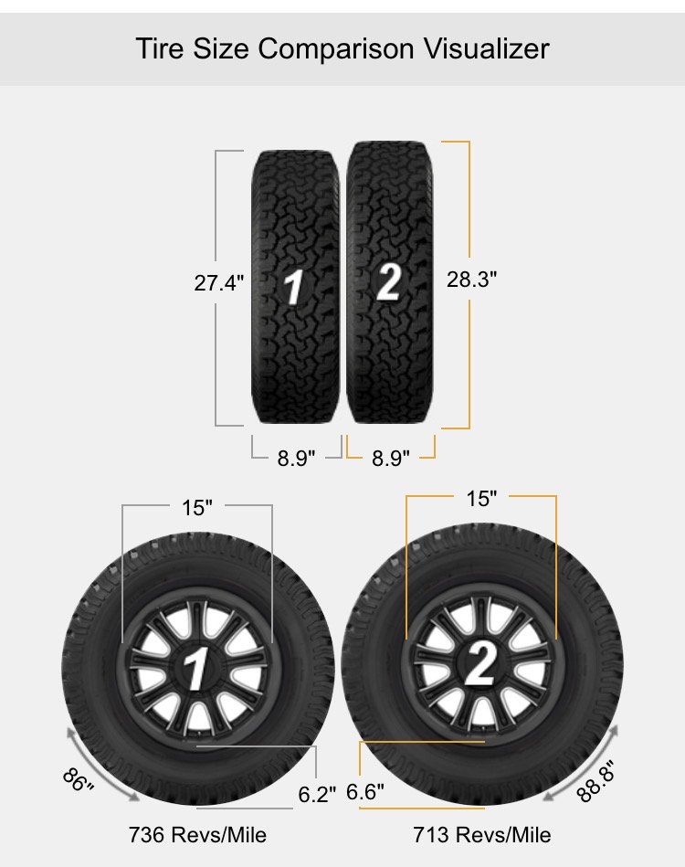

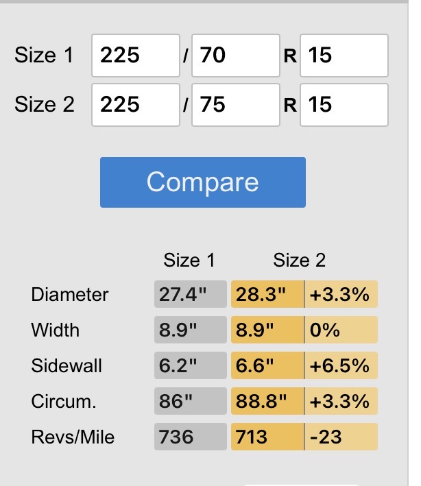

As far as inaccurate MPH is concerned- I have 225/75R15 tires all around while the stock size was 225/70R15 , since my tires are a bit taller my speedometer already reads off by a bit depending on my speed.
Once everything is swapped and I'm test driving the truck I'll compare the Speedo to GPS on my phone. Can I then set the needle to the proper speed according to GPS thereby negating the difference due to tire size?

3.3% difference in the mileage, 1.65 mph at 50mph.

When it comes to resetting the needle, it’s a direct add the math thing, not a proportional thing. If it’s reading 7 mph off at 35 miles an hour, don’t change that to a percentage. Just add/subtract 7 mph to wherever the needle comes up when it’s on the battery.
And you’re correct in you’re thinking that if you use your GPS to reset the needle, that will automatically take care of any difference in tire size.

Thanks Rick. I've used online tire calculators to figure the difference in size and variation in speed at different mph but I didn't know there was a phone app that does the same thing.
