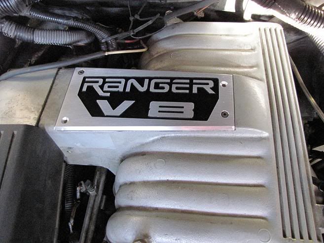

If you're gonna keep it looking stock like it does now, its gonna make a pretty neat sleeper =D
Funny you mention that:
Dan's 5.Ohhhh Build thread
2/3 drop in (Had to replace both rear Leaf springs, Bummer :( ), 4.10's in, K+N in, Just gotta fix the mess of wiring under the hood, find myself the right slip-yolk, and start having some fun.
