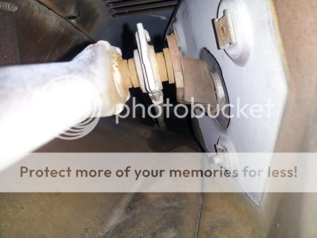

On my way home the wipers were making weird sounds, clunking more like it when they were moving. Well ended up going to the store for a few things, took a left hand turn out of my apartment complex and heard another clunk. I turned on the wipers and only the passenger side was working. So after getting back home and with the help of the finances brother who happen to get home early from work, got the bar, which those that have a gen 1 ranger know how big that access hole is under the hood to it all, back on the wiper. Went on a bit too easy but at least it's working now and it was nice outside tonight.
And for those that don't know what that tight space looks like and how much of a pain it is to get your hand in there, my phone took the pleasure of giving you the visual.

Sure is. That's looking to the driverside. I'm happy with the little rust i see in there too.
Had to take my air cleaner off to get my hand in there better. Got about two thirds of the way up to my elbow before i could get on there anymore. The skin on my wrist took the damage.
