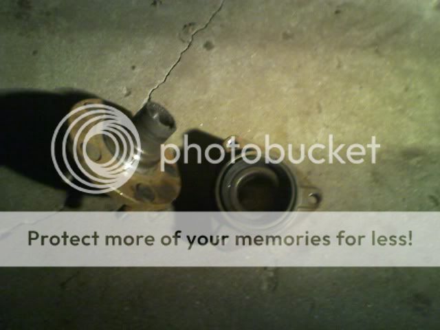

Well been having brake problems ever since I went and got my engine, all the suddenly was lossing my pressure, pedal, etc.. so though that the master cylinder went bad and got a new (remaned) one. Poped the master cylinder cap and thought this was the problem.
dangerranger1983 build
No change. So changed tha master cylinder, bench bled it, etc and that didnt fix the problem. Maybe the brake bosster was it. Un did it and ran it as if I had manual brakes and still didnt fix the problem. So dug deep down and though to myself and remembered that this has happened before to me but this couldnt happen to this part after just 5,000 miles....and was I wrong, it was the problem.
Another exploded bearing, passenger side again. I think its still under warrenty so going to go get that problem sovled and never going to buy another advance auto bearing again.

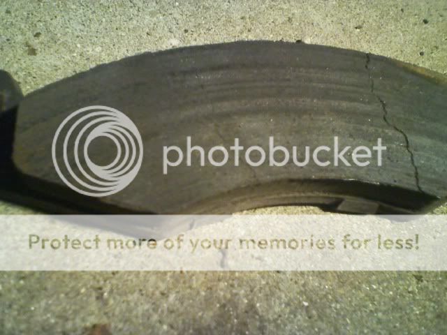

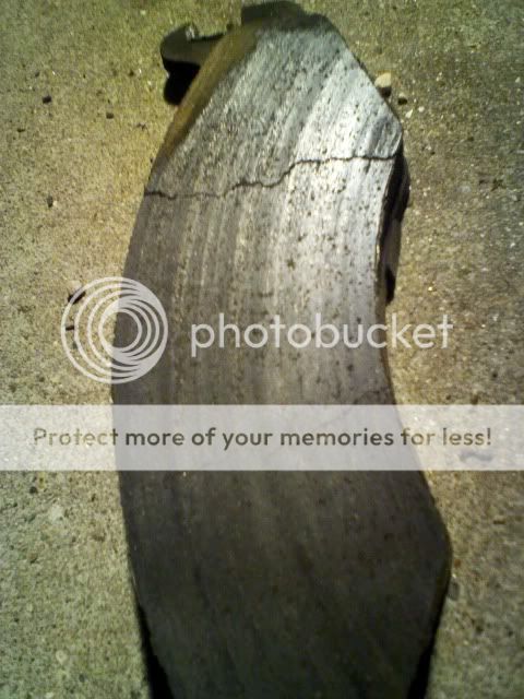

And when I took the brake caliper off I also found out that this had happened to my brakes due to this. Good thing they have a limited life time warrenty so have to go get them replaced.

Oh ya you are seeing 2 cracks. One is all the way through and the other is partal.

They are proud enough of those unit bearings of any brand you gotta get the good ones and keep the receipt.
Kinda goofed me up there for a little bit, couldn't quite place where you pulled that thing out of on a first generation... then I remembered your D30 swap. :icon_twisted:
How much are you tightening the axle nut? The bearing shouldn't come apart like that no mater how bad it is.

My last one came apart in 5 pieces.
