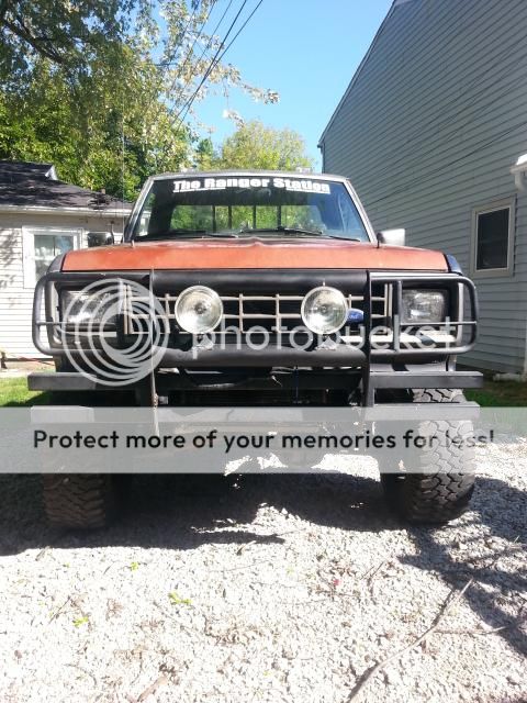

Why does it look like the top of your tires are tilted in???
or is that just the way the picture came out??
Robert
posted using a CCA 1500 and blue flame
Picture does that but also I think the driverside unit bearing is going out, I haven't put a new one on it since I got the axle and did the swap almost 4 years ago. Also going to be doing ball joints on it too.

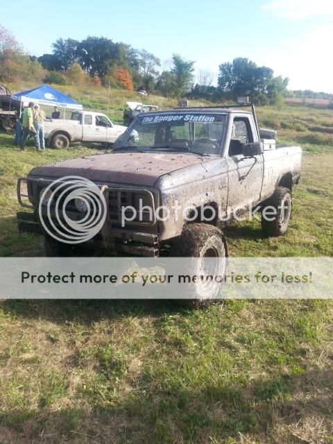

Had a blast but didn't get as many videos as I wanted. Truck did perfect and had no issues with her.

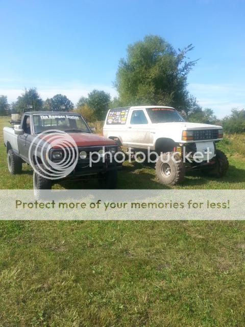

1983 5.0 Ford Ranger mudding 2: http://youtu.be/YpbxUDq_WS8
Got there and parked next to this. A Bronco with a 400 that had a B2 body swap.

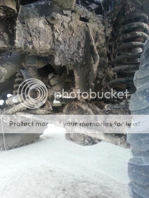

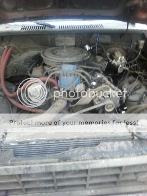

The engine will get cleaned back to the way it was.
dangerranger1983 build

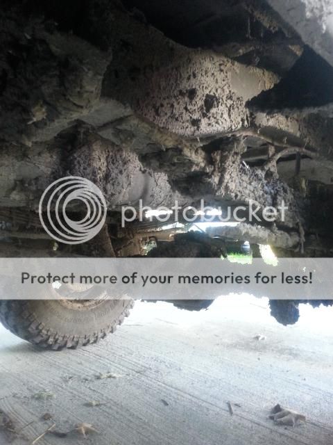

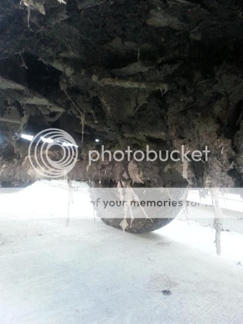

Almost done cleaning the under body.

I've done must the under body, just need to do the rear suspension, the body and the.engine. Hunting season for deer is coming and so is winter so this was the only play I am going to be doing this year.

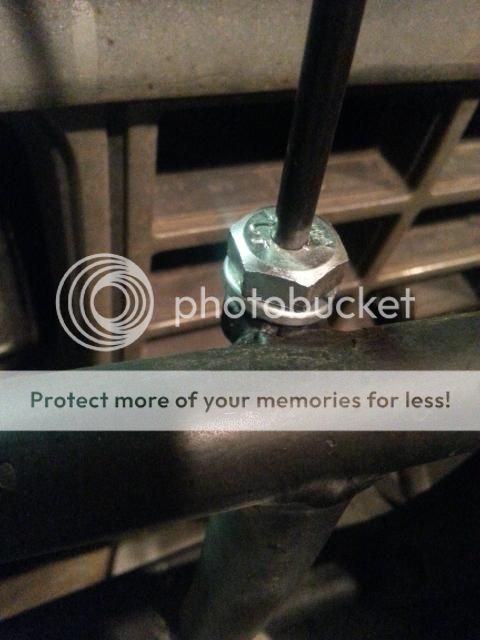

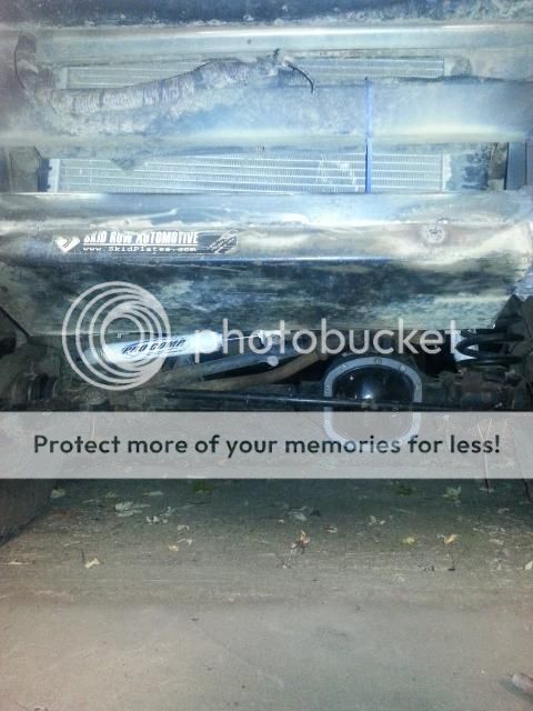

Heading to a local off-road park the 25th with Ben Parker, it will be out first time going there. I'm getting my truck prepped for it so far I have the flag and it mount on the truck along with just finishing up welding a skid plate to the bumper to protect the lower radiator from getting as easily damaged.

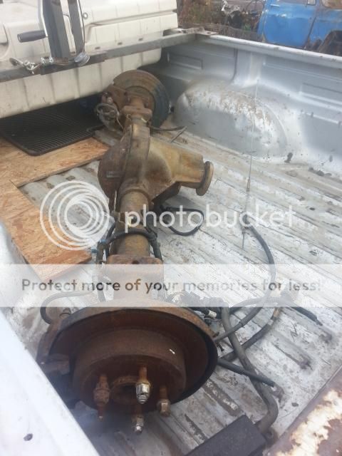

So for $150 and already pulled, got me an explorer 8.8 l/s with 3.73s
Going to also upgrade to the 3 inch flange and get rid of the 1310-1330 ujoint when I go to install it.
Ooo nice! I've been thinking about doin this to my truck too. Don't some come with 4.10's?
Yup sure do. But because I have 3.73s already, decided to stay with them. Going to either rebuild the clutch pack or shim it to last another year.
