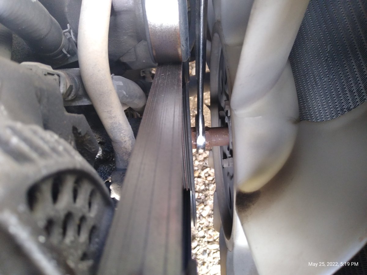

This thing will not come off the water pump. God dang, how are y'all getting this to come loose. I tried tapping it with a hammer and tapping a drift punch on one side of the flat to spin it., I tried going backwards a tap or two. Nothing is working

Fan clutches are usually left handed threads. Try tightening it to actually take it off.
they sell and rent a tool that grabs the bolt heads on the pulley to help hold it still.
3.0l uses reverse threads on the fan clutch, left hand threads
Should be a "note" on that on the top of fan shroud or a label on rad support
Im not certain of all vehicles but my rangers come off turning clockwise
Rule of thumb is to look at the water pump pulley
If it has ribs for the "front" of the belt then its reverse threads
If pulley is smooth then its regular threads
crank spins clockwise and has ribbed pulley so any accessory pulley with ribs will also spin clockwise
And if the water pump bolt for fan clutch is spinning clockwise then a regular thread would tend to loosen up because of the fans resistance, it would unscrew itself, so reverse thread is used
Smooth pulleys would spin counter clockwise, usually idler/tensioner pulleys but also water pump pulleys
On V-belts they all spun clockwise, lol, so reverse thread on those as well
This one turns clockwise. I had to take the pulley loose from the water pump and put one of those tools that use the bolts on it to hold it from turning and then put a wrench with a two foot bar in the end to get it to come loose. It's all done but the spinning of the fan back on

Did you replace both the clutch and the fan?
So, the idiot that serviced my truck before I bought it, put a new water pump on it and used loc-tite on the fan clutch....
The fan clutch was bad, couldn't get it off. Used a sawzall and cut the SOB off. New water pump was 20 bucks.
