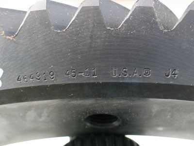

If they still have the axle tags on one of the differential cover bolts:
Method 2 is for absolute certainty, on the ring gear there will be 2 numbers (45-11), divide the larger number by the smaller number (in this case, a 4.09 ratio). These are the tooth counts on the ring gear and the pinion gear.
*edit: I had a feeling pirate would block the picture, replaced it and edited description.
