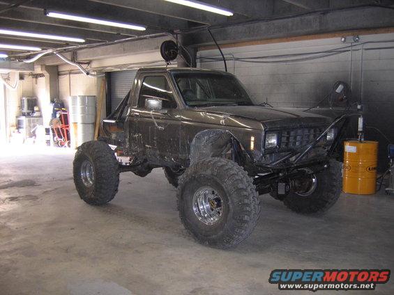

Got her moving on her own power yesterday, wow that suspension is ubber soft. Granted I don’t have shocks on it yet it. Flexed it out with the fork lift and man does it flex. More then before, didn’t go until it lifted a tire as the front fenders need to be trimmed more and they where eating the tire.
Have deduced that I will need a master cylinder to move more fluid after just having the front brakes working. Run brake lines to the rear axle, shocks, weld the rear, make anti wrap bar, and general clean up and she is ready to go.
Then 5.38 gears and a front locker. Pics to come after she is complete. It looks Ridicules!!!

After flexing it all the way out after cutting the fenders shock placement is a little difficult. My 15” travel shocks are going to limit my suspension a little. Without shocks I measured 26” of front travel. Should be around 23” with the shocks. Should be done with the towers tomorrow. Also getting a F 350 master cylinder, and doing the rear shocks. Then paint all the shit I just made and then its pic time.
