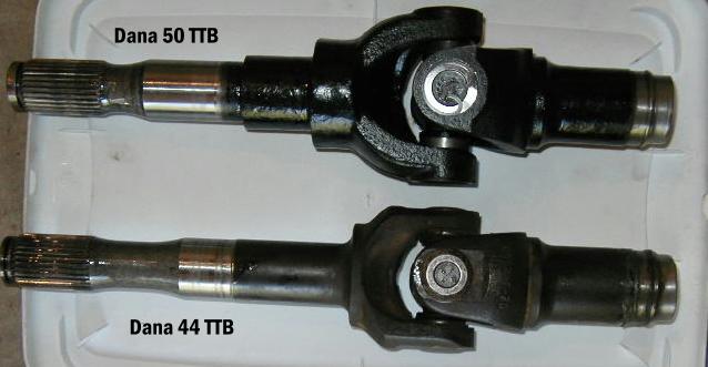

dana 50 vs 44. the shafts are different on the 50....u joints.
there is one in cleveland too... they are pricey at shelf yards....usually 500 bux or so.
to be clear the shafts are 1350 joints so they wont fit your knuckle holes....the piglet will bolt on...but the shafts ....not so much

we have used the 50 center in the 44....but there were other mods to get seals and a bearing to work....
it allowed us to use a marc williams yoke for long travel suspension....

The dana 50 ttb is different. The dana 44ttb and the dana 44 ttb hd should be the same? The dana 44 ttb was in the f150 axles, the dana 44 ttb hd was in the f250 axles.
yes....it is different. the d44 hd centersection use different shafts, some have an odd joint as well..not all...there is a variance. the 44 hd center section should be same as 150 as i understand it. just has the different size shaft spacing.
