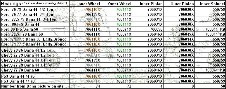

The Mr N Dana 44 page is down, but the internet lives forever
