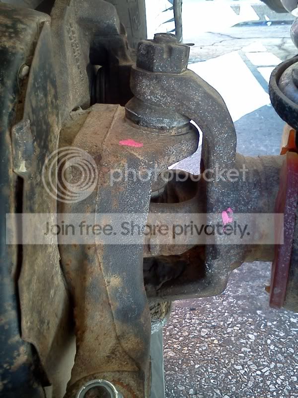

So I was doing a little research and it seems I need certain Chevy or Jeep knuckles for high steer. The 2 sites I found said there is no enoungh room on Ford knuckles to mount the brackets. And based on the pictures they provided, I believe them. The problem is my knuckles don't look like the ones posted. And look to me to have enough room. Can anyone shed some light here?
Those are the same knuckles on my Dana 44. I just went out and checked. If you want I can take a pic right side up
But those are not flat top knuckles.
You need chevy/Jeep knuckles.

I know all that. I've done the research. And apparently there are 2 differen styles and mine can be machined so I am in luck.
Yes Dustin, you have the style that can be machined to run high steer...and for your application you will be fine :icon_thumby:
SVT
So I can run high steer with my knuckles too???
Maybe...post up a pic and I'll tell ya. But you can pretty much tell offhand if you can. Look at a high steer arm, and if you have about the same shape next to the BJ, then you can have it machined flat and drilled/tapped for the high steer arm...The knuckles that can't be used for high steer have considerable less material around the BJ...

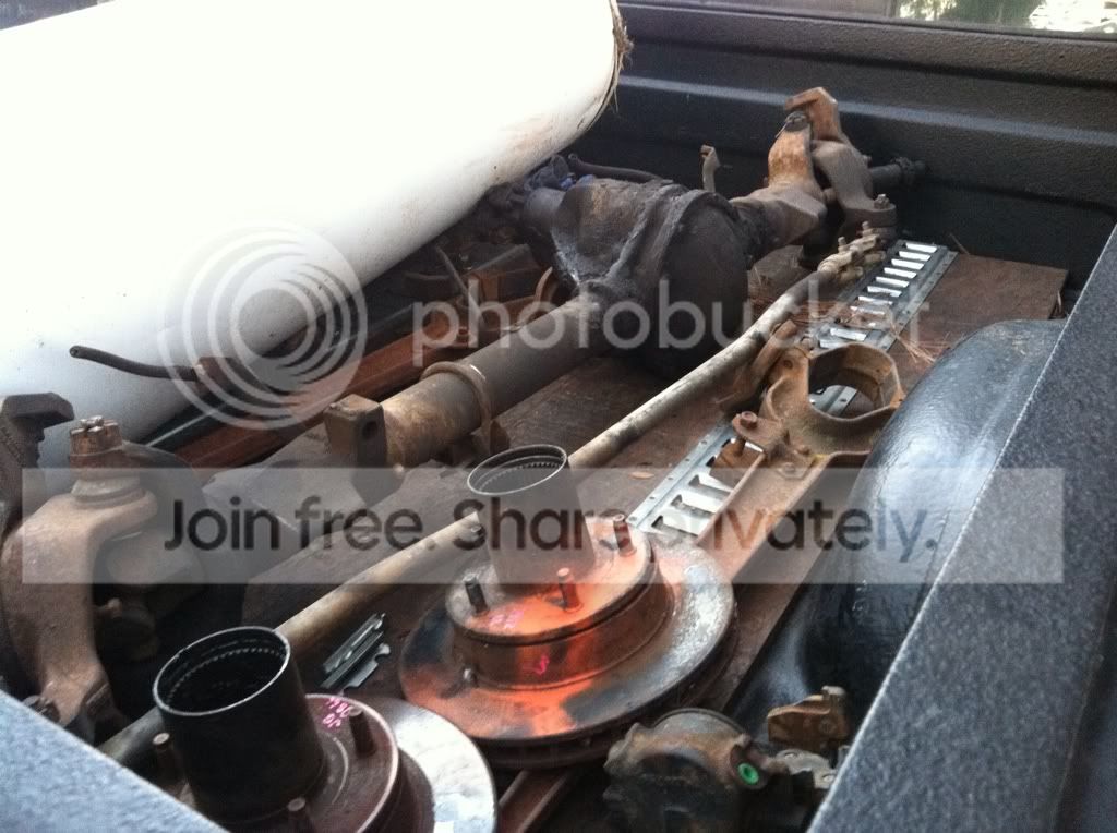

I put did cross over on mine axle. Its out of a 79 F250

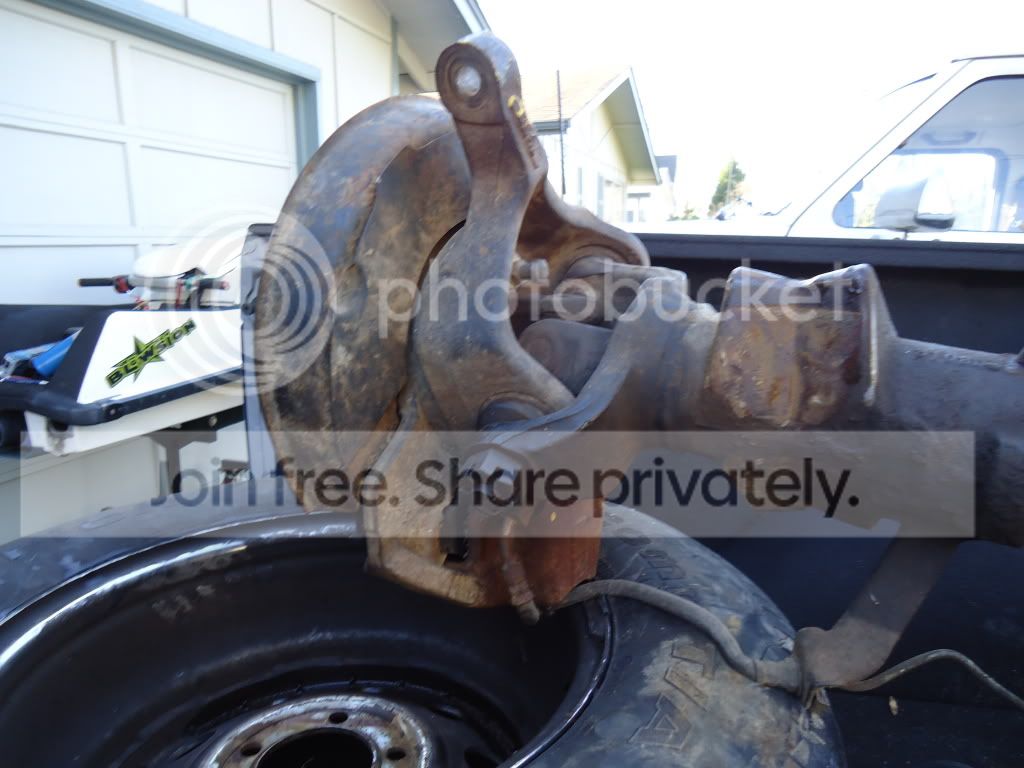

Here are mine.....from a 78 F150
There is a place to put highsteer arms next to the BJ, BUT the material thickness there is way too thin IMHO.
I have the same knuckles as the 1st two pictures. But I have always been told you cannot mill and tap these...not enough material. Have to use 3/4 ton knuckles or buy Reid Dedenbear knuckles....or switch to shevy knuckles.
Exactly what I thought:)
