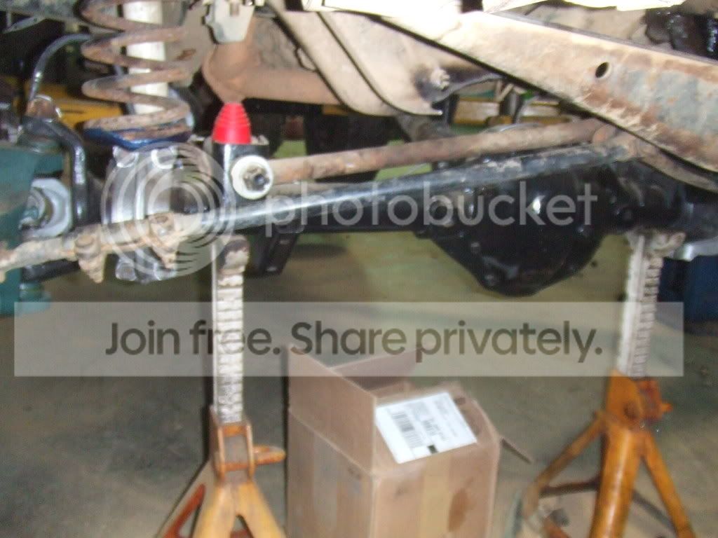

cutting out for stock bronco track bar
bronco track bar bracket welded in and made to fit

welding up trac bar bracket
had to cut bottom of bracket to clear steering

If I was you though I'd reinforce that track bar mount, tie it in to the engine crossmember. One good hard turn and that will tear the frame.
