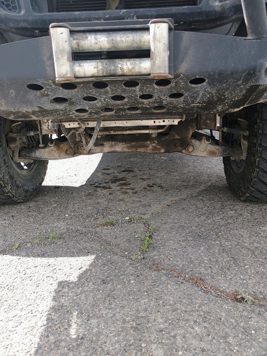

That would improve off-road capability pretty drastically though right? Here's a picture of my current axle.
A solid axle swap would drastically improve its capability, yes.
It's not exactly a simple undertaking though..
