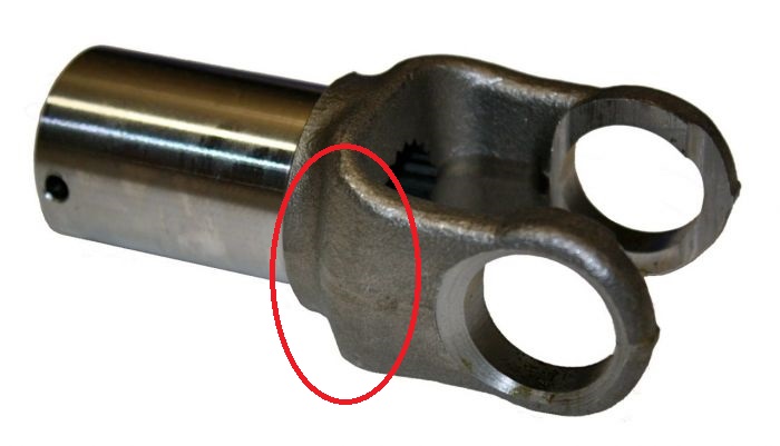

Also, you can try this, sometimes the yoke ears get bent in a little... give each side a nice sharp tap or two with a hammer in the spot I circled. I don't know exactly what this does, seems like it spreads the ears or something but it makes the u-joint move smoothly after installation.

Hey guys thanks for getting back but Josh b as far as I know everything is a 91 ranger I bought the truck from some guy cause I wanted the cab it had 4.0 motor which was shot auto trans dana35 8.8 rear but can was rotted out so I cut it up and junked it but keep the frame and axles trans and the transfer case .and gump the needle bearing were good the issue is the cross is too wide for some reason I even went and bought different joints the do the same thing as I said before I took to a mechanic and he is baffled too I even put heat to them nothing worked I even tried to spread the ears with a porter power no good this is driving me crazy I got the driver side done with no issues but both right side one won't go together so i guess I'm just gonna have to buy the right side axles
