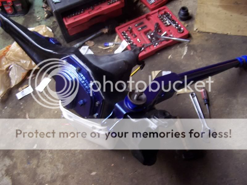

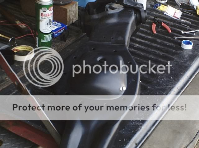

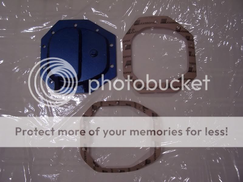

ok so this is the ring for the cover made of 3/8" steel.
Dana 35 access cover?
diff cover installed1
ill have picks up tomorrow of the build and install... she looks really awesome...
sorry this took so long but i didnt get the diff cover back from the mill lathe till yesterday...
You know that does look pretty good. I think the blue helps out as well. Nice work. Hopefully it serves the part you are hoping it will.
