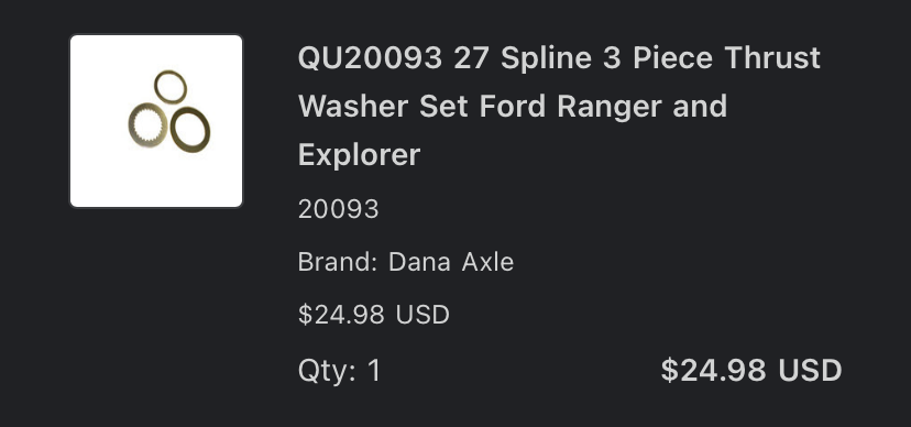

Another option would be to put the 3-piece washer setup from a '95-'97 truck on there, the 3-piece is an inner plain washer, a nylon (Delryn?) washer, followed by a (thinner) splined washer. The plastic piece acts to reduce the friction and grinding on the end of the spindle. They are hard to find though (I'm not aware of a pt# to buy them new, you may have to find them at a wrecking yard).

97 w/ dana 35 here. my thrust washers were missing entirely. ordered these from torque king.
