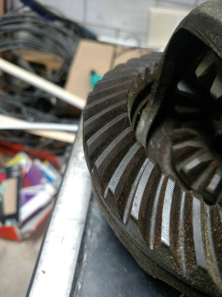

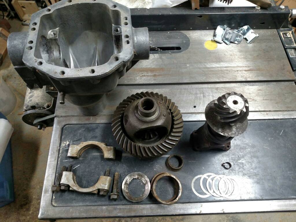

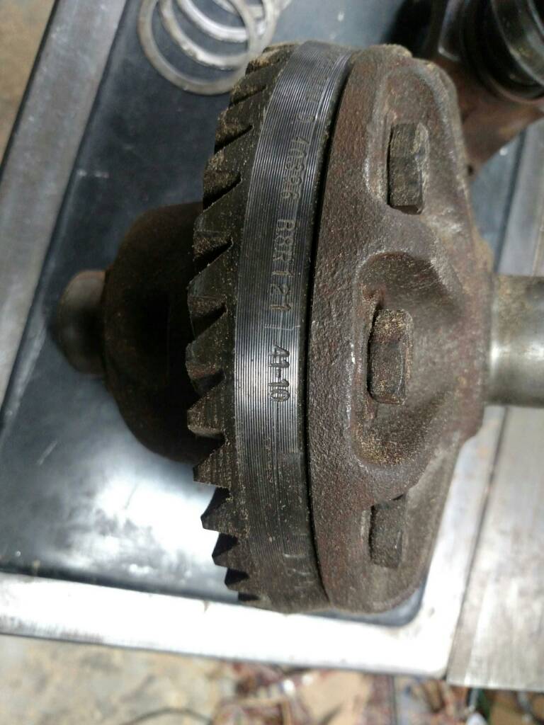

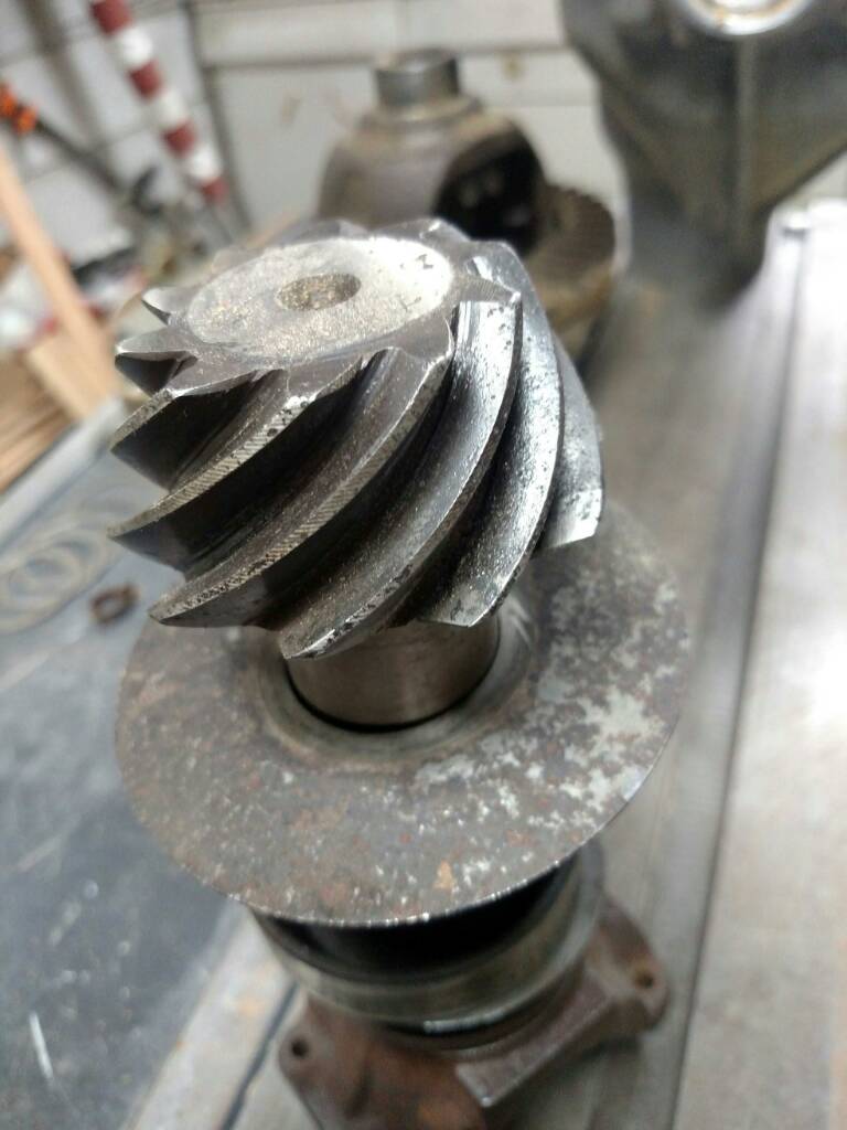

If you want, I've got a complete Dana 28 center assembly with 4.10 gears. Gear teeth are lightly-moderately worn. It needs a complete master rebuild kit, as the old bearings and seals were destroyed when I got it. I disassembled it, removed the bad bearings and seals, and cleaned it completely, so it's ready for rebuild.
I was going to install it in my '88, but then that truck got squashed in an accident, and I don't need it for the '97 I got as a replacement.
I'm thinking maybe $50 + shipping from 83274. PM me if interested.
