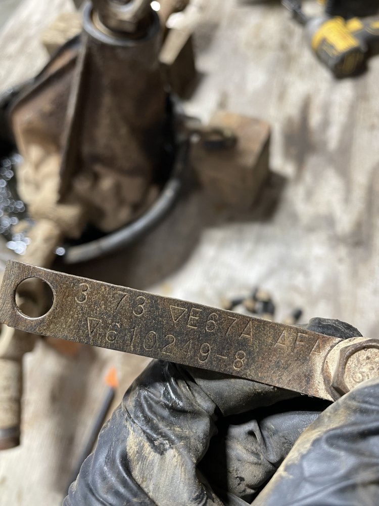

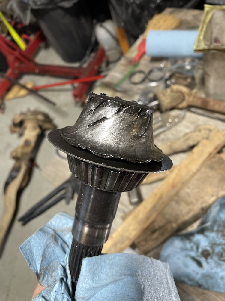

Looking for a replacement drive pinion for my 87 ranger from differential.
I'm not sure what you want. The pinion gear is specific to the ratio of the ring gear. It would be easiest to replace the whole pumpkin that had the correct ratio gearset in it. Or are you talking about something else? Pic would help...
I need a replacement drive pinion. 3.73 gear, Dana 28. Other gears look ok.

You can’t just replace the pinion, you need a ring gear also. They’re a matched set.
