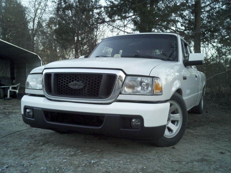

Few updates on the truck:
-sold the fr500s
-added explorer ohc and lighted visors
-hit a dog and fubared the bumper so I replaced the lower bumper, added fog lights, and plastidipped the upper bumper

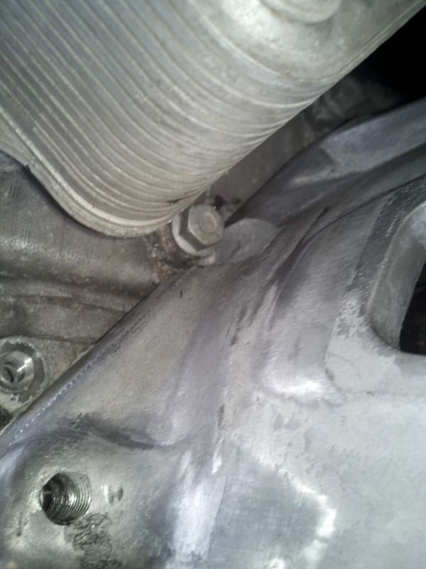

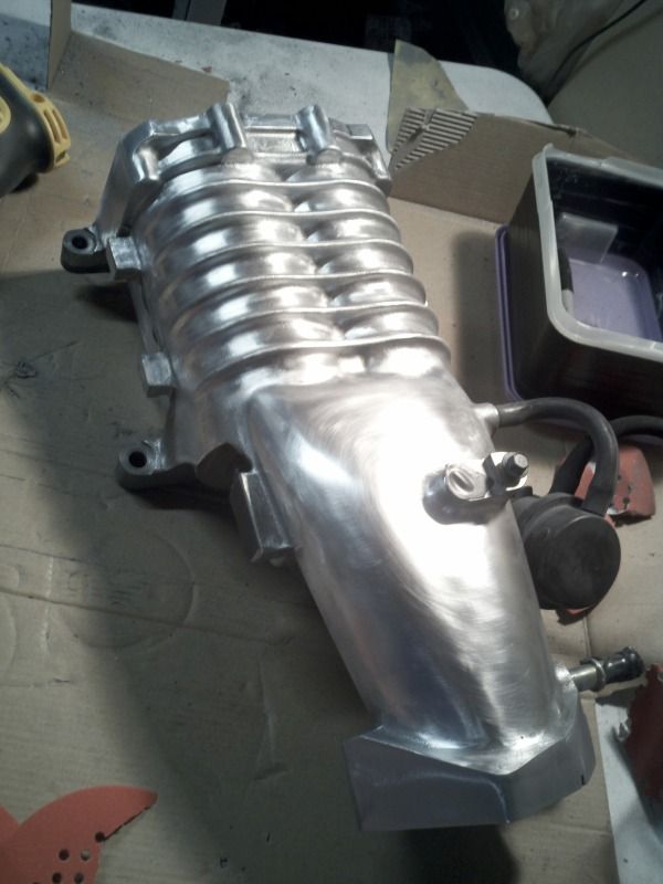

Weekend updates...wheels plastidipped black for now, bellhousing had to be clearanced to clear bolt on the oil cooler, bellhousing successfully mated to engine, supercharger torn down to have new coupler and such replaced, started polishing supercharger. I hate polishing rough aluminum.
