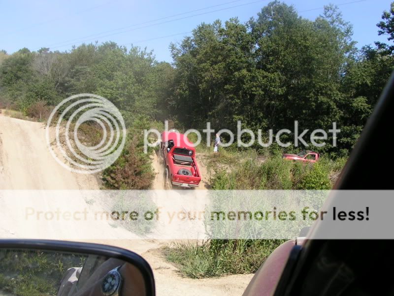

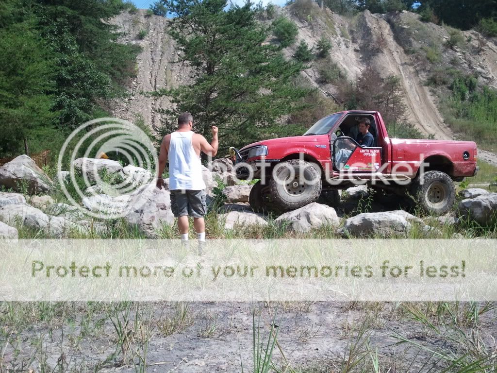

I went wheeling. It happened. I have pics. :thefinger:
Met up with the Kentucky crew at the Hi-Lift trail day at Redbird in Dugger, IN.
Looks like it was fun.
Sent from my HTC using Tapatalk
