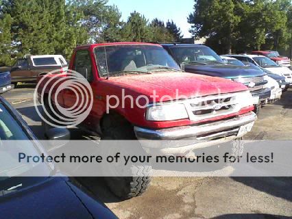

I survived Turkey Bay. It was allsome. Check the show off forum for a TON of pics. I'll just highlight my truck here.

The truck performed very well both on and off road. 750miles round trip. Set the cruise at 70mph and just rolled out. Even with the tube doors on and the bed loaded down I averaged 20mpg. The two times I filled up on the way down I got 19.91 and 20.12. I didn't pay attention on the way home haha.
