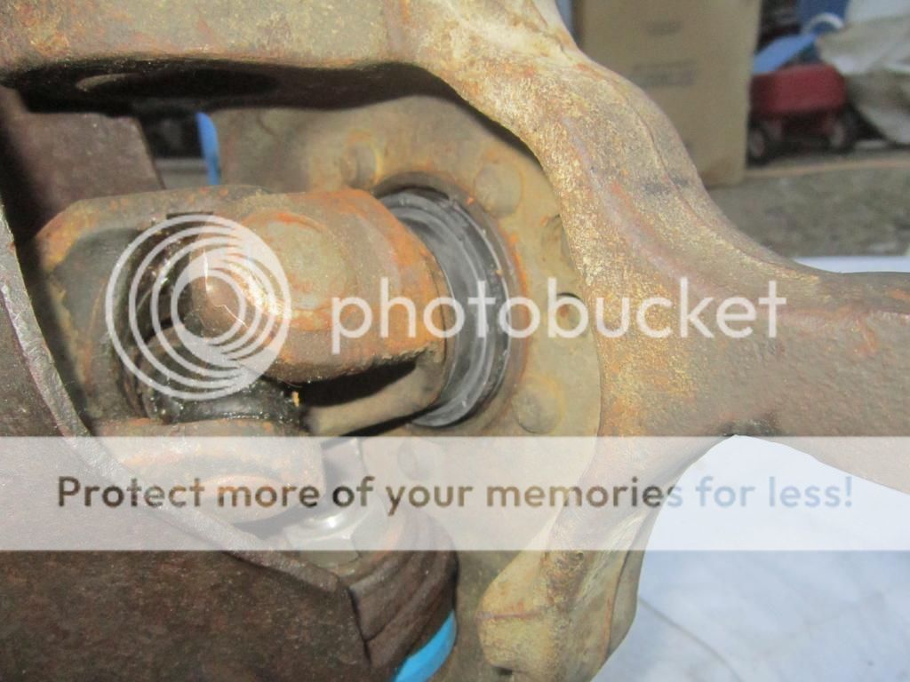

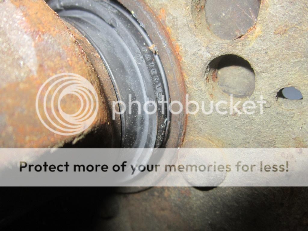

Here's some pictures of the outer seal in place for reference:
Your post led to this and getting my memory jogged, so I do thank you for that. If you or anybody else have any more commentary on the subjuct, I would appreciate it.
Ok, you have the later setup (used on most '93-'97 D35s also).
I have a feeling the earlier setup may be better based only on the fact I've yet to have any water getting in through mine where a couple buddies with later rigs did (I'll admit I don't know the full maintenance history of their rigs though). If anything, the earlier ones do seem a bit easier to find.
