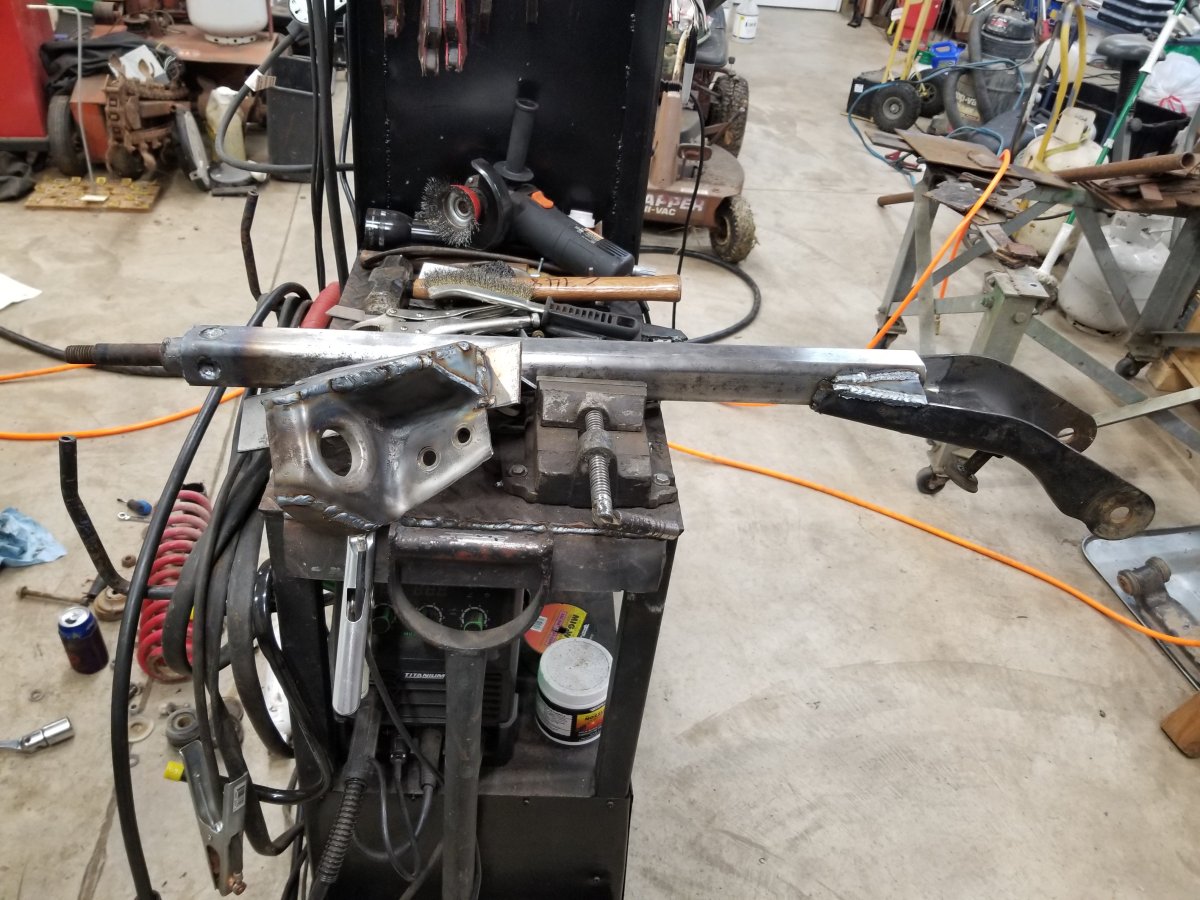

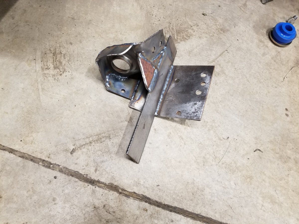

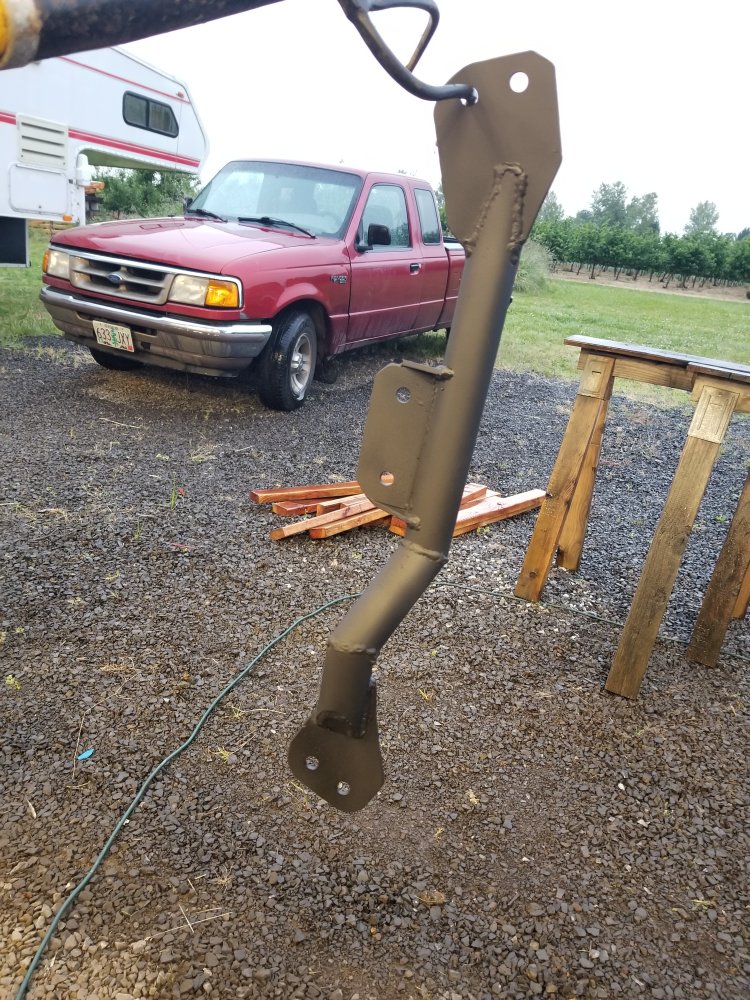

Here's a pic dump of how things went. Took me forever to stare at it and figure out how I wanted to do things, everything ended up being pretty abstract and random but worked out. The radius arms are pretty much what everyone that does the square tubing radius arms does just longer since I wanted to integrate the transmission crossmember into the pivots, lost a couple inches of ground clearance there but gained it where the stock radius arm crossmember was so a wash I think. In the pics I still need to drill the front and back into the frame to bolt them in and I still haven't done that but it's on the list. The transmission crossmember turned out pretty good but was not easy to get the angles of everything right. Considering about the only measurements I made were to get the wheelbase even side to side, the radius arm lengths even side to side and the beam angle I think it turned out pretty good! The top pic of the pivot bracket is before I added some more bracing you might be able to see in the pic of them painted. I ended up with no radius arm bushing bind at ride height.
You did a nice job!

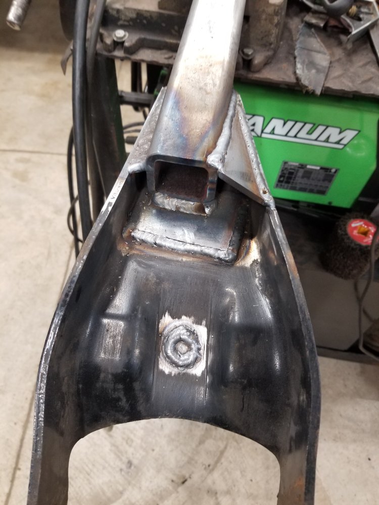

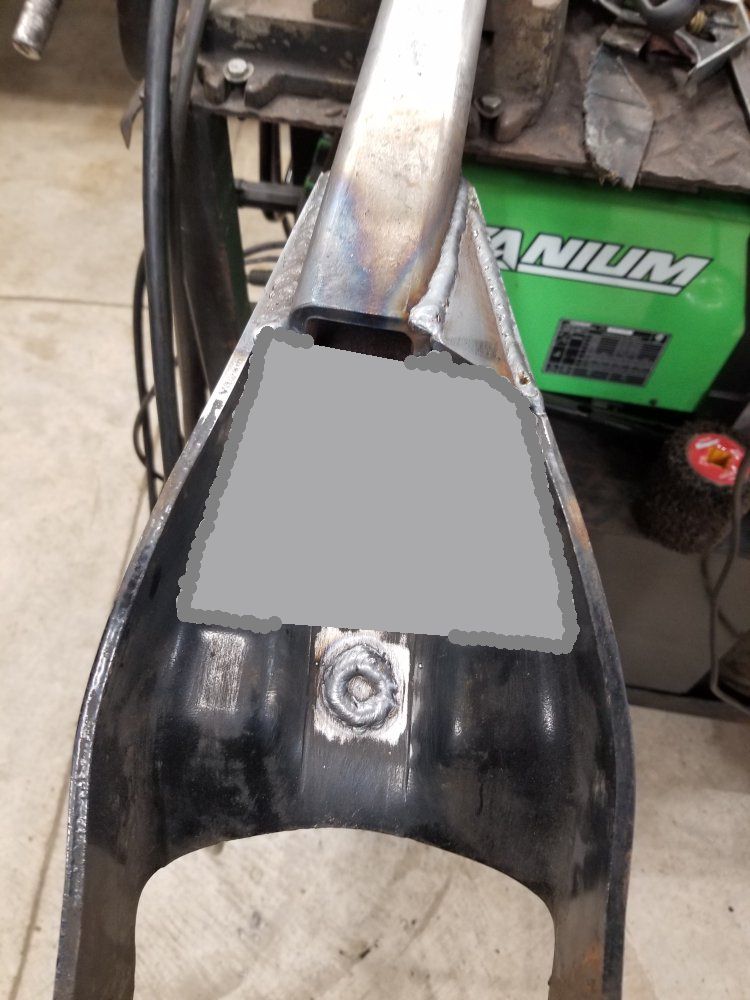

Only thing I might suggest is add a plate to the area right behind the end of the tube inside the driverside arm (boxing it in partway). This because the torque moment coming from the differential puts a ton of stress on that side and causes the arm to twist a bit. Mine eventually cracked right where the weld meets the edge of the arm (passengerside however has been fine).
(pardon my photochop welding skillz lol):

Apparently it seems I don't have any actual pics of this floating around... Tried to get some, but with the arm installed makes it a bit tough. Hopefully you can make out the plate I used (also where I had to fill the crack along the bottom).
D35 TTB beam angle
Good to know! It's not quite too late to do that, less convenient but not too late :), don't have the radius arm bolts in yet just the bushing nut tightened...

Have the start of a cardboard cutout for the gusset, will get on that tomorrow, gotta shorten it up a little and tape on another tab :). Got the arm out just fine, had to take the steering joints apart but they needed to come apart anyway since I need to straighten out the kink in the passenger side link, one of these days I need to make myself a swingset but the stock setup seems to work so far somehow for me...
