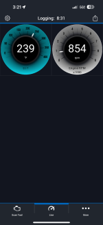

I have a 01 ranger with the 2.3L motor, I was using my blue driver scanner and noticed after driving 20 minutes down the highway the ECT was 257 degrees F on the reader.
The 2001 models don’t seem to have coolant temp sensors and instead have a cylinder head temp sensor. Is this a normal temperature or something i should look into? Previous owner had a shop replace the thermostat, coolant temp sender, and coolant back in 2021.

I’ll datalog it tomorrow on the way to work and see what I get. I appreciate the reply!

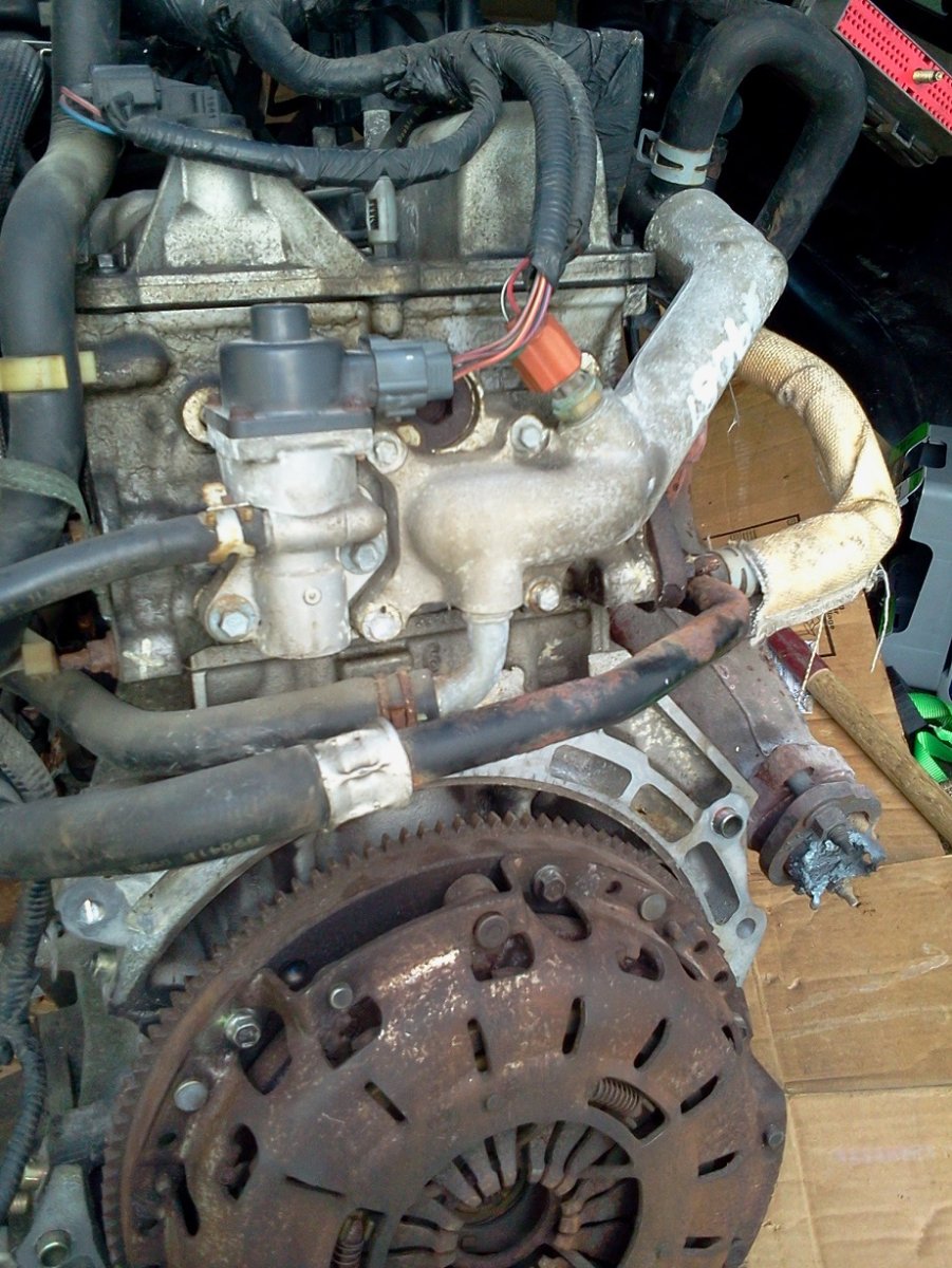

the orange connector is the ECT sensor.
conveniently located on the rear of the engine.

Gauge is just below 1/2.
