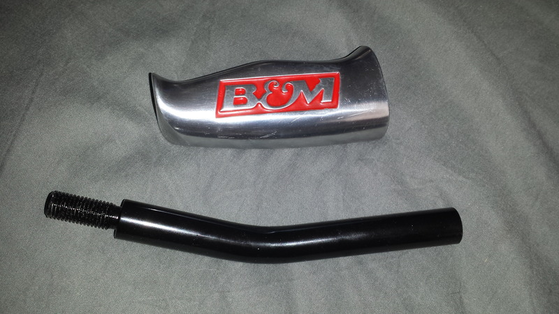

Found a $20 ebay special "bent extension" designed for other vehicles, BUT the threads are wrong of course...we have no threads, but the hole in the stock shifter is nearly a perfect fit for the m10X1.25 threading on the one end of the extension(slides right in). I would of liked to thread it in a perfect world....but I believe that JB Weld will work fine if cleaned well. Plus if I can find the right ID stock I will sleeve it as well. The other side of the extension has inside threads so I *could* just put the stock shifter on it, but it is broken...like every other older Ranger I have had, so I am gonna thread the outside for a B&M T-shifter, again used Ebay special...again about 20 bucks.
Waiting on the die(1/2 20) to fit the T-handle(dont hate..I know the T handle is not really meant for a 2.3l manual trans shifter, but I have had one before and I loved it...plus its quite comfortable...). I will try to post some pics up, but it is pretty straight forward.
The bent shifter was "SickSpeed" or something, advertised as anodized black brass, but it looks like painted steel..lol...havent scratched it deep yet..lol, oh well should be easy to "die". Not my first "rodeo" so to speak, I just gave it "loose" test with the old broken stock handle and the length and bend is perfect for me. Just have to stretch the rubber boot up to cover the "joint" between the stock and the extension....dont want it to look completely "rigged"...lol. Will powder coat the aluminum black eventually and fill in the B&M logo with the same color as the truck as opposed to just black or the red that it came with.
Anyway....hope this isnt too "jenky"...everytime JBWeld comes out things get kinda weird...lol...but I think it should work just fine... Wish I still had my metal lathe to make that 1" sleeve to go over the top.... that would help hold the boot too.... sigh. We will see. Might have one made...but this is still suppposed to be a "budget" mod. I could get tricky and JBWeld it THEN drill from the side and pin it....but thats alot of work...lol....(Its HOT in Missouri right now)...heheh... More concerned about stretching the rubber boot...have to figure out some zip tie concoction or something....ideas welcome!!!..:)
Again, will post some finished pics if it isnt too hot outside of the install and the finished mod for anyone that needs/wants the same thing. Here are the pretty parts....:)
