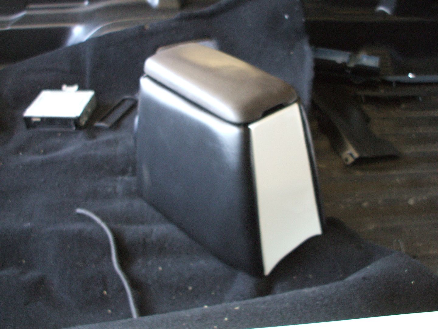

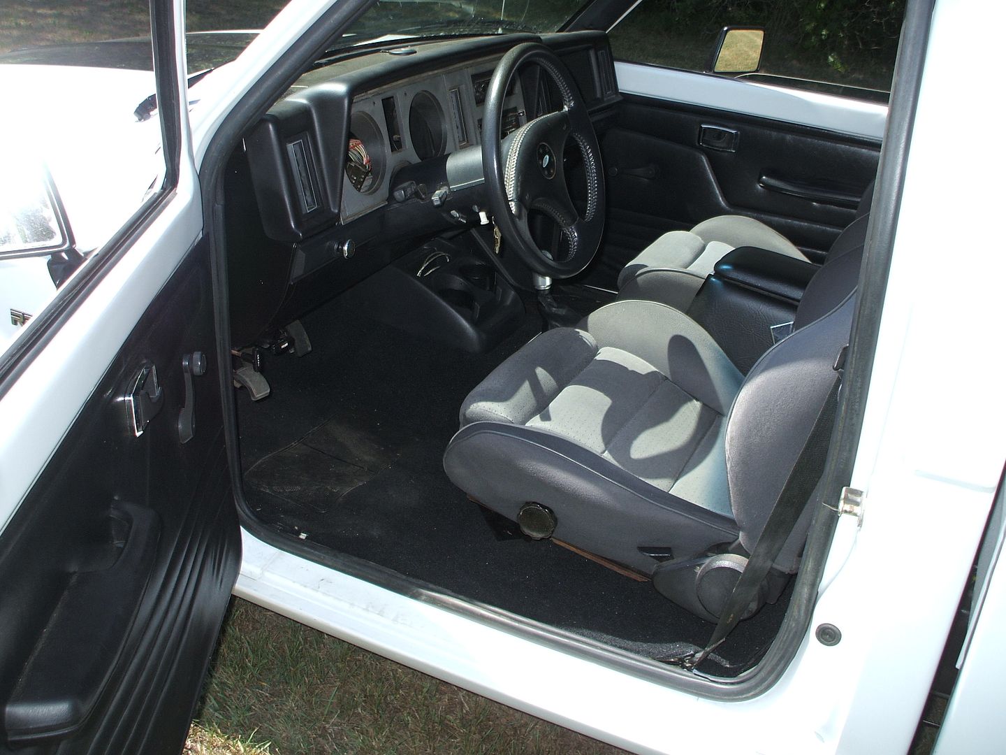

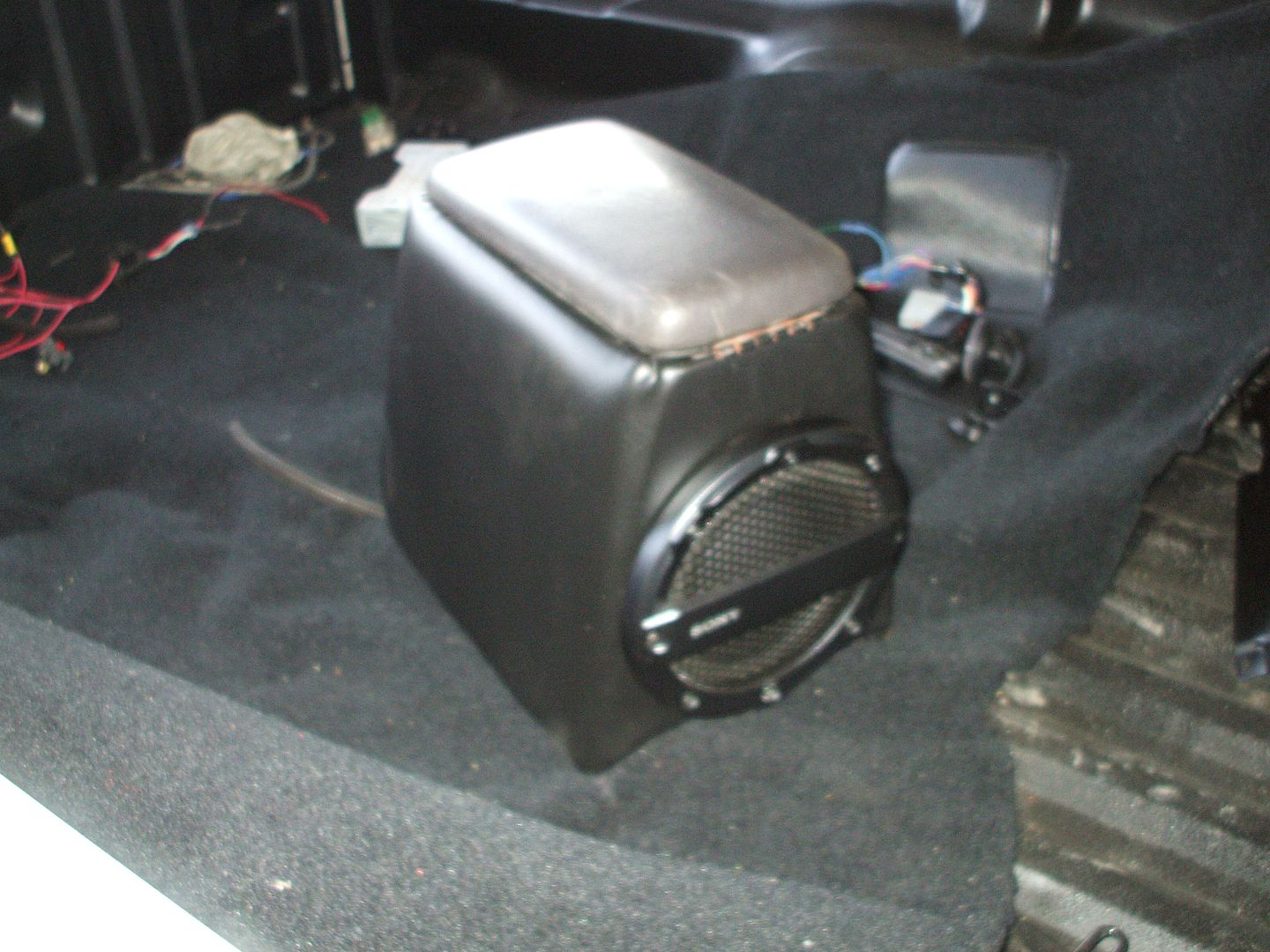

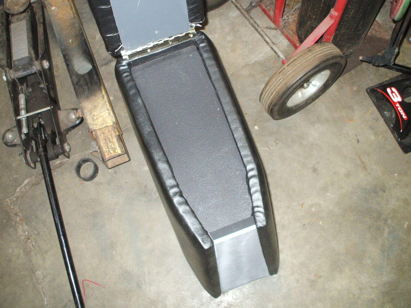

Mine is an 88 so I know the dash is different but just for some ideas here is what I came up with.

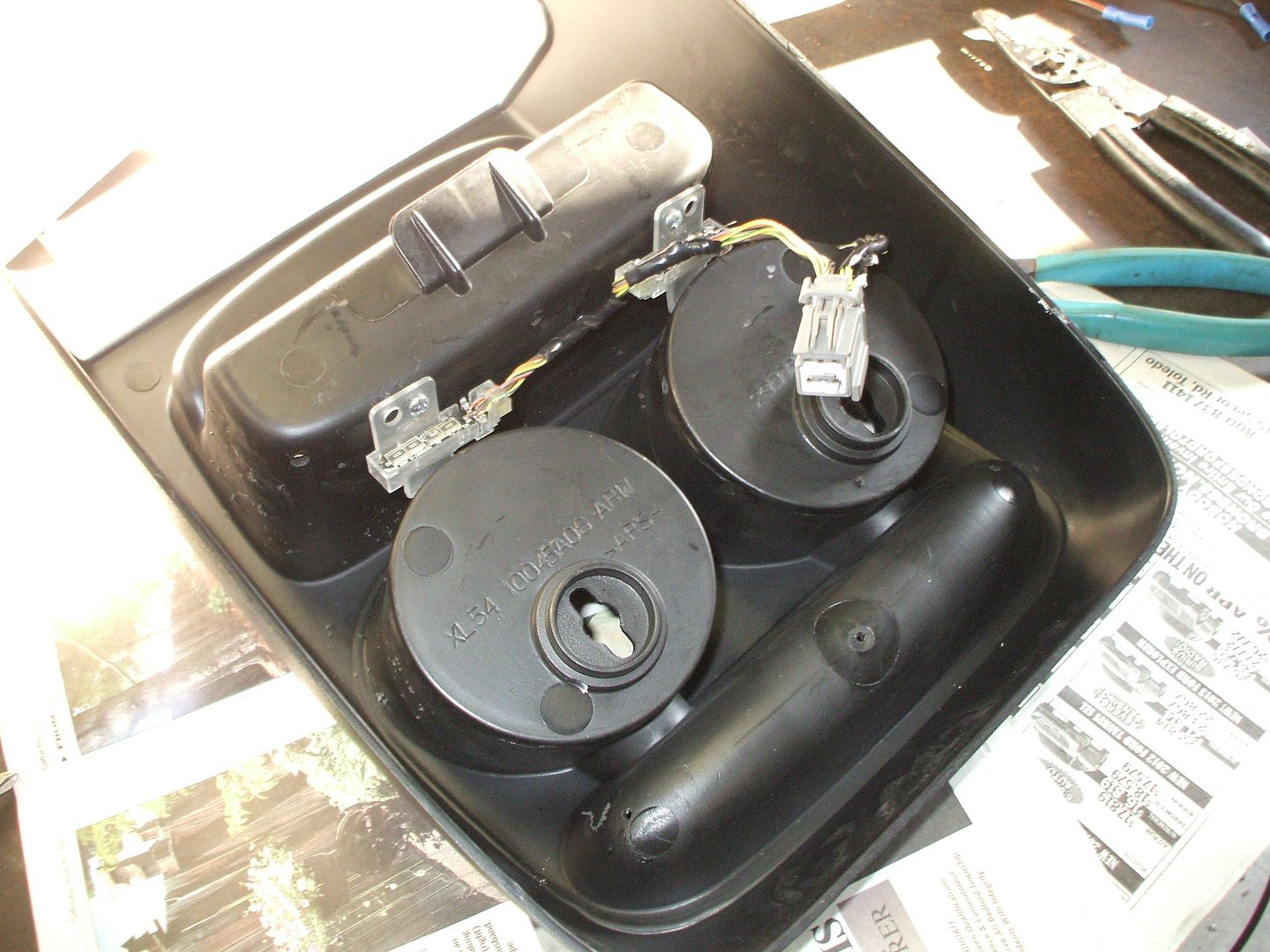

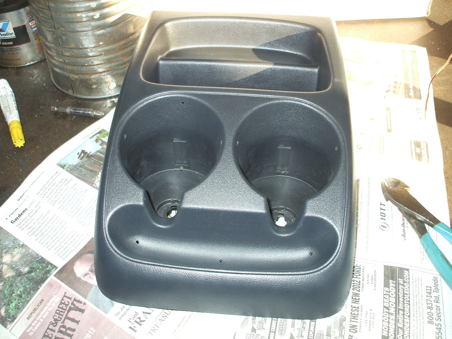

I got a cup holder out of a 99 Ranger.
Drilled it and back lit it with LEDs

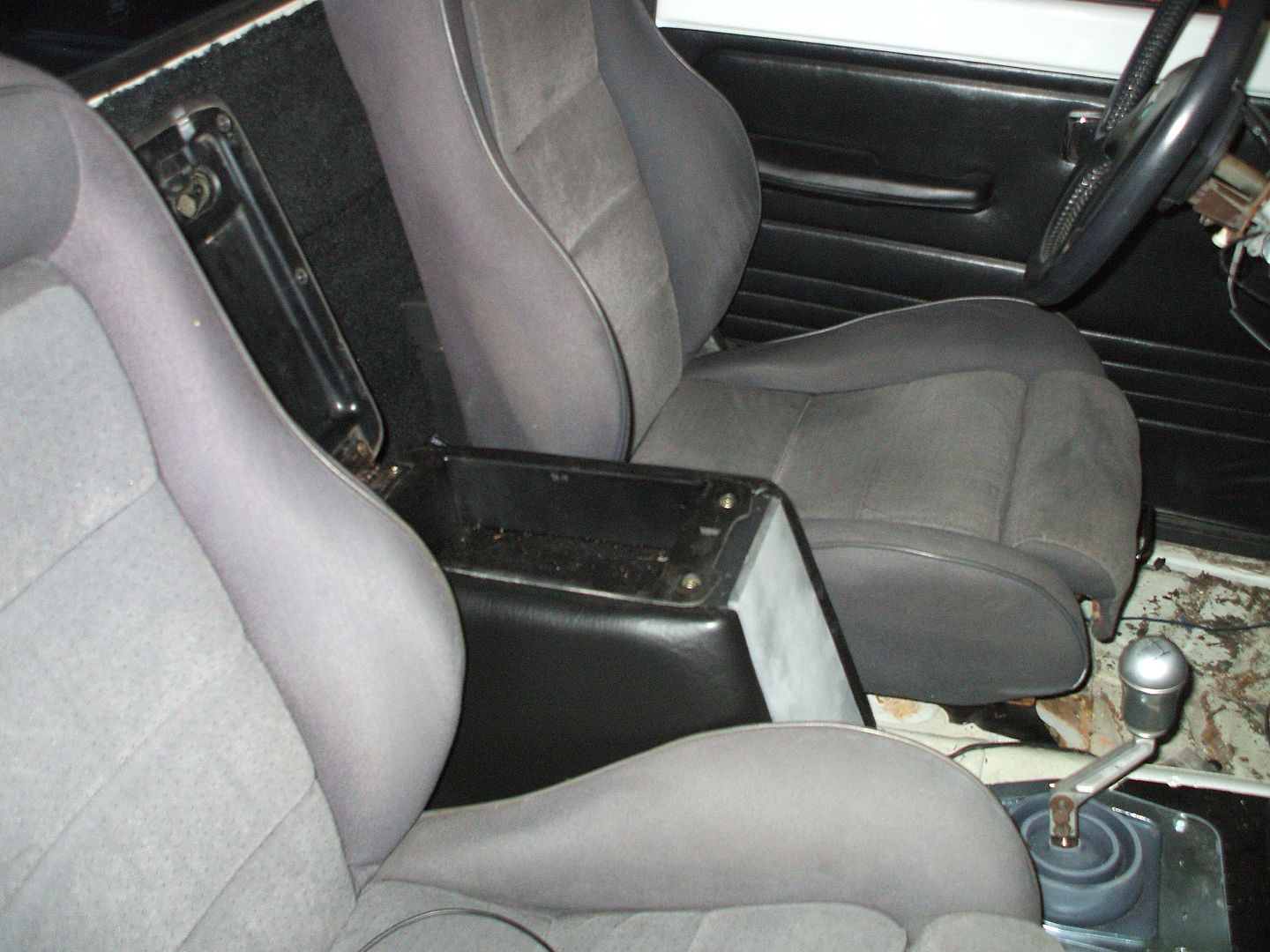

Then built a wood box to hold a 8" Sony sub and a Jeep storage tray and lid.

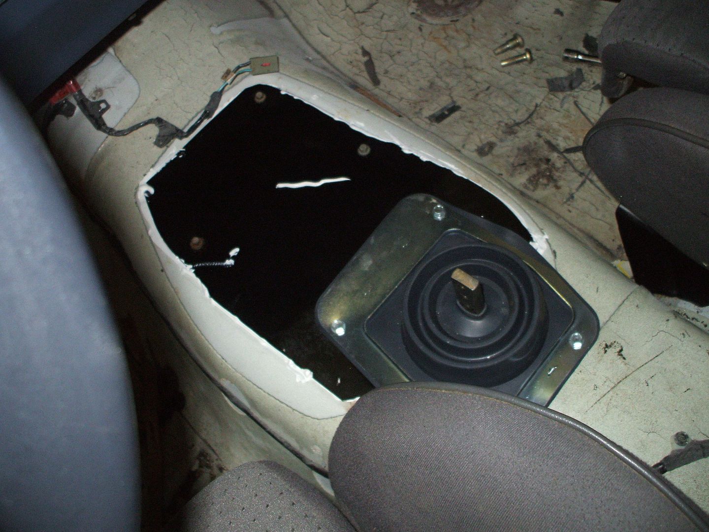

Then I used a foxbody floor seal with studs welded to it and a custom trim ring I had made with a foxbody boot and Bullit knob.
And this year I switched from a t5 to a c4 and I made my new shifter fit as well.
