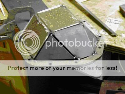

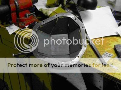

Added capacity diff cover with serious beef, I used 1/4" plate. Pretty simple design and was easy to build. I welded inside and out to make sure my welds wouldn't leak gear oil.
I like your style Bones, too bad our diffs aren't round like the AMC model 20, I'd cut a section of pipe and cap it off, presto; it'd be ugly as hell, but work.

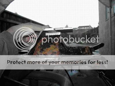

just finished mine yesterday, im still contemplating adding some flat plate inbetween the 2 vertical rods on each side of the ring gear though.
Flat plate on that guard would add some performance as well, making it like a ramp so it can slide up and over stuff easier.
yeah i thought about that when i was making it, but i want it to be able to drain if it gets mud or soggy leafs trapped in it. maybe cut out some butterfly bandaid shapes to weld between the rods, then drill a hole in the center or them to lighten em up? i mostly wanted to make sure i wouldnt smash the cover when backing down my side yard to get my dirtbike trailer. the gutters on the house go under ground until they get to low ground, then they come out of the ground and they are surrounded by medium sized rocks to keep the drains from getting smashed .......... so this should solve it! or maybe i should just not be smashed when im getting my trailer?
eh, I think a custom diff cover for protection while smashed is a good plan.
I agree some additional plate would do well, just don't run it the full length of the bar on all sides and you won't have a problem with it holding material.
