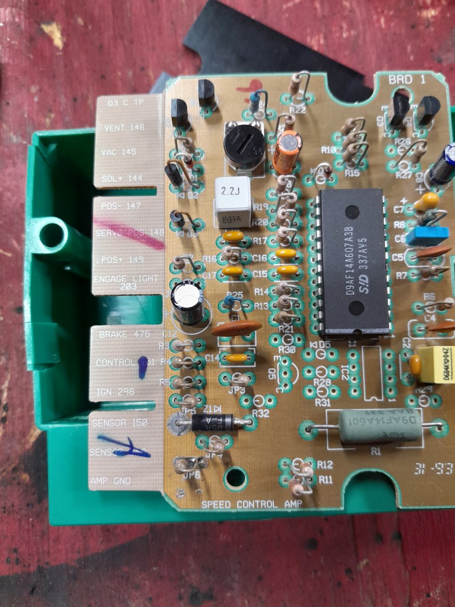

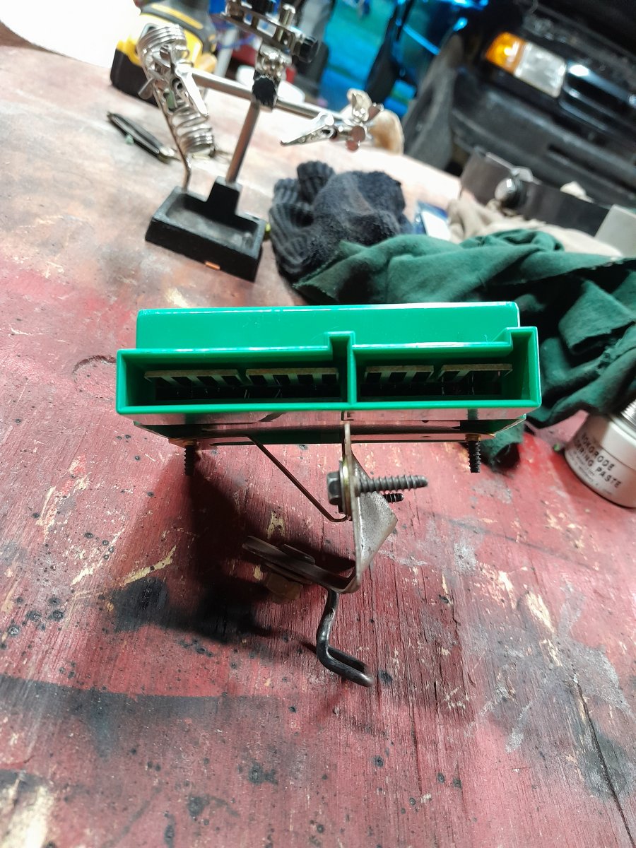

There is also a printed circuit board (aka amplifier) mounted under the dash just above the glove compartment that could be acting up. You have to drop the glove box compartment down by pressing inward on the sides.

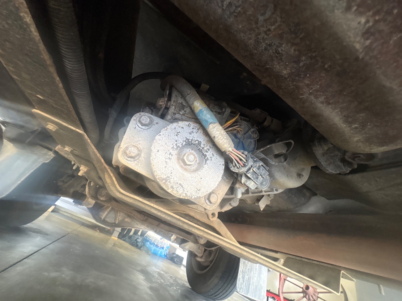

In your case, with 4x4, your speedometer cable is connected to the transfer case, driver side, near the back end. In addition to the mechanical cable for the speedometer, it should have a device there with wires to give an electrucal speed signal for the cruise control.

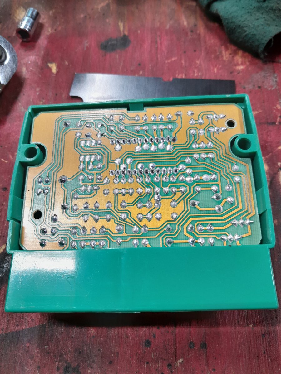

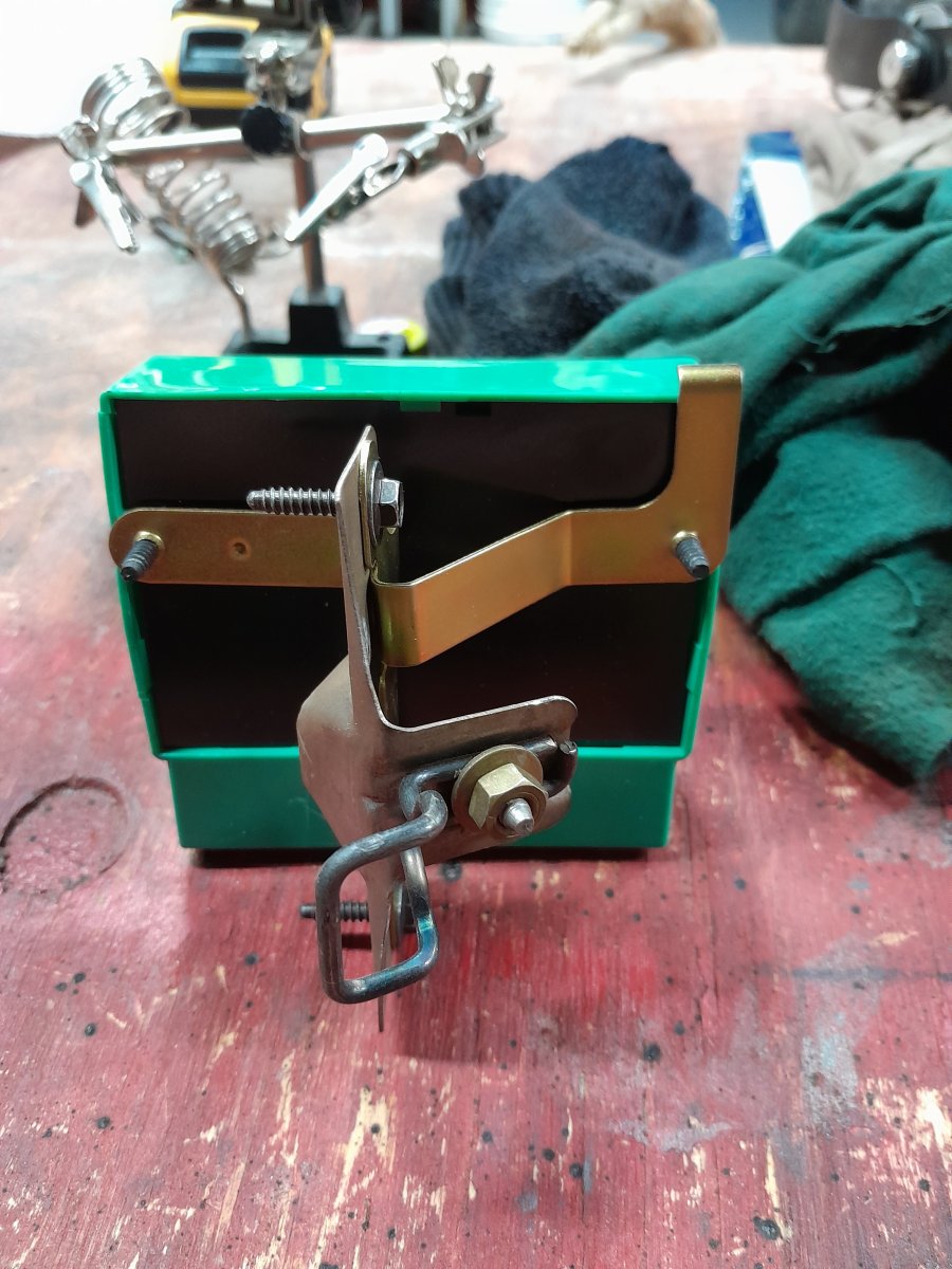

here are a few images of it after removal. I think you'll need a 5 mm socket.
20220723_205835.jpg 20220723_205901.jpg 20220723_211002.jpg 20220723_211110.jpg

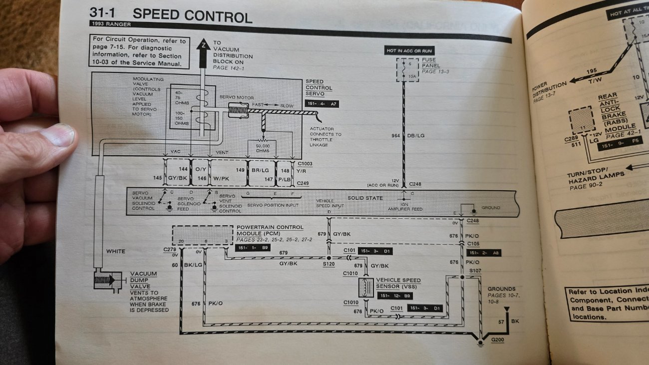

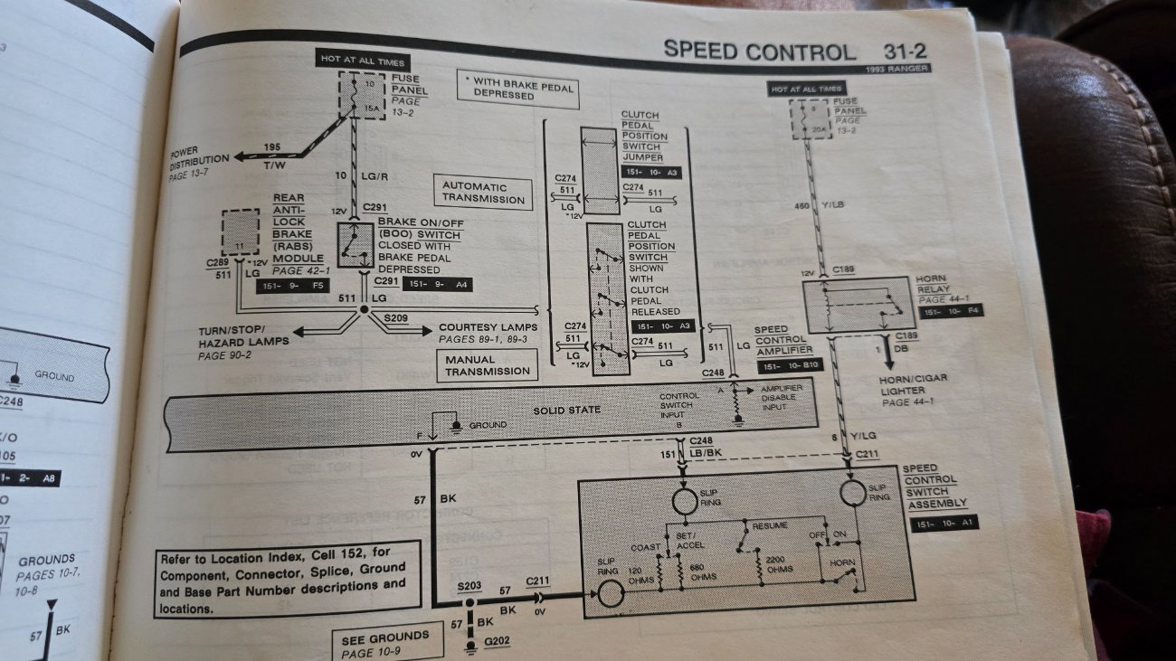

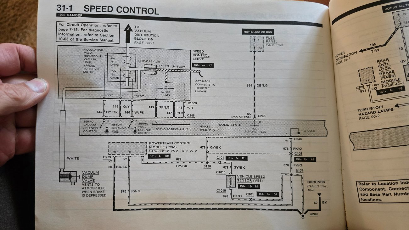

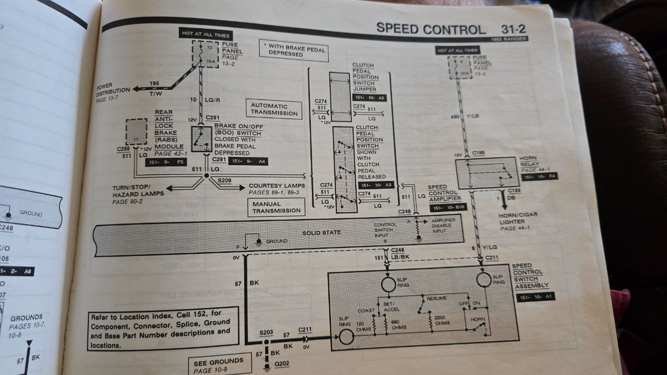

In the mean time, here are the pages from the EVTM. This is 93. But 94 should be the same.
This stuff?
