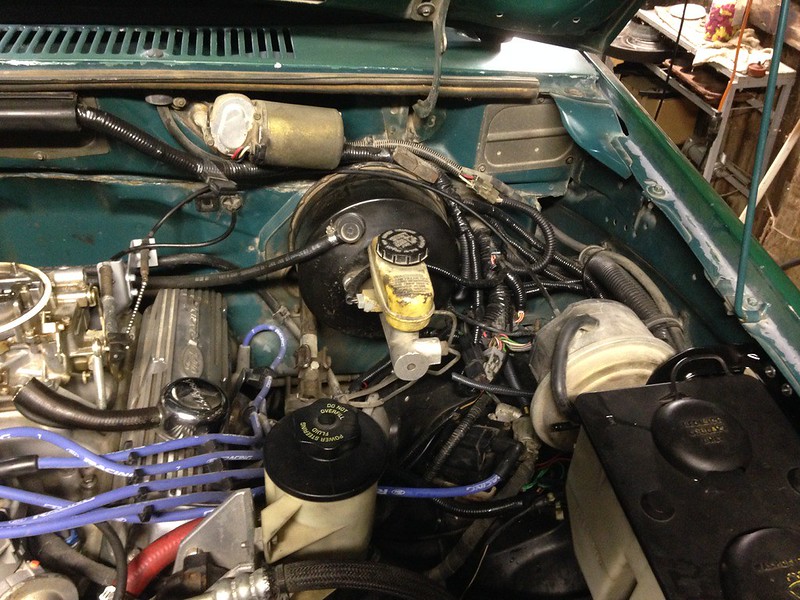

Mine is carbed, I used a cable from a carbed '85 5.0 F-150 and it fit perfect :dntknw:
Watch the connections though, I know in thru the early 90's they were changing servos and the connections might be different.

I can't find a pic of a Mustang engine bay that shows a servo so I don't know how far they have to go. An EFI F-150 cable might work though.
