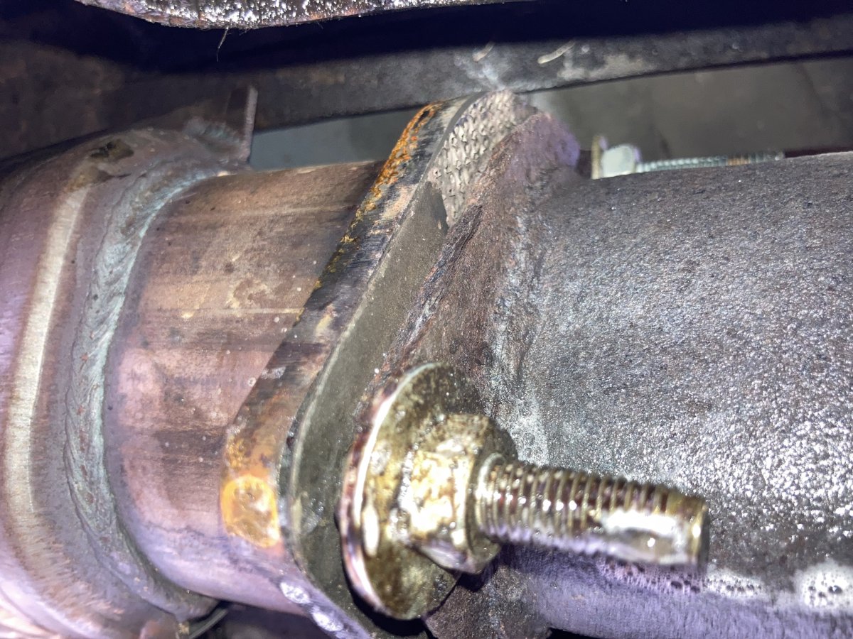

Pic below.
You can see that the cat on the far side of the connection is healthy (it’s brand new last summer) and that the flanged end of the y pipe is simply missing around the perimeter. This lets the gasket flop in the wind and let out some exhaust.
These pics are from before I replaced the gasket and also caked on a bunch of exhaust cement just to see how that performed.. lasted a while but now it leaks.

Anyways, I like the idea of dropping it off at a shop and providing the clean new segment of pipe/flange. I could just say “hey cut this here and replace it with this new segment and weld it.” But the pipe is pretty close to the underside/frame/body of the truck. Im not in front of truck until tomorrow but I vaguely remember only an inch or two free space above the pipe. Is that enough space to weld a pipe together end to end?
As for acquiring a replacement.. yeah if I’m welding then it does suck to chop and waste a new y pipe… are these flanges in some way standard? Can I just buy a flange, buy a foot of pipe, hand those to the welder and say replace this end section of Y pipe? Is the bolt pattern of flanges a common one? Is there a name to this flange style? It’s got 3 bolts.
