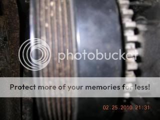

My timing belt replacement project is ready to remove the crankshaft pully, and have tried two wheel pullers and can't get them to get a bite on the engine side of the pully, can I hook onto the radiator side raised lip and pull the pully from there?

Need to remove the fan belt drive pully, the black groved part so that we can replace the timing belt.
you need the harmonic balancer puller... remove the 22mm center bolt and washer, and 2 of the small bolts still inside of the pulley and rig up the Harmonic balacer puller
if you have one of those pullers that you would use longer bolts through the 4 that hold the outer pulley on with, tighten those then wack the pulley with a dead blow hammer (dead blow is key, I love my dead blow hammer) on the top then the bottom, this should get it loose, probably take a few steps. With the puller make sure to thread the center bolt in a few threads, you did get the washer that goes under the bolt head out, right?
Yea, the bolt and washer came out without a fight but I cant see any other bolts in there. It looks like a smooth bowl in there. I can see the crankshaft and the shaft key at the 12 o'clock position.
The washer is just the small one that is on the bolt right? Just a little bit bigger than the bolt head? or is that big ass bowl thing another washer?
no, that's the crank, some people have a heck of a time getting the crank pulley off and are trying to push against the washer that holds the pulley on... it's best to just push on the crank bolt
i just took the crankshaft pulley off myself. After I removed the 4 10mm bolts, i layed down on my back, looking up at the pulley, I used a pry bar and just popped it off from the back using the block to pry against.
you are definitly going to need a balancer puller. I just bought one from Advance, works like a charm. What you do is put the center bolt back in and give it a few turns and use that as the pusing point for the center bolt of the puller.
