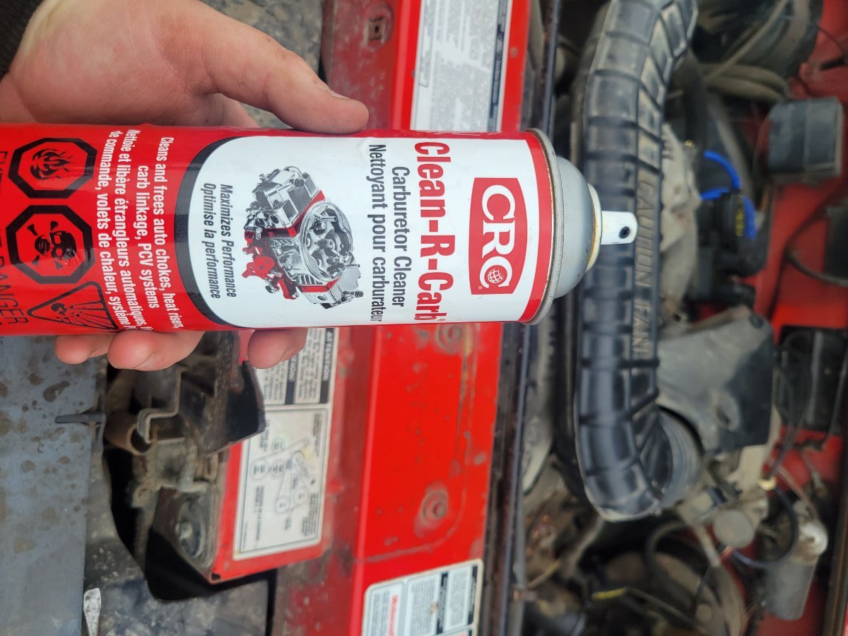

@93ranger4.0l , since it starts on starter fluid, 35 psi on the fuel rail is too low for the 4.0l OHV:
• check for leaks
• fuel pressure regulator
• injectors
