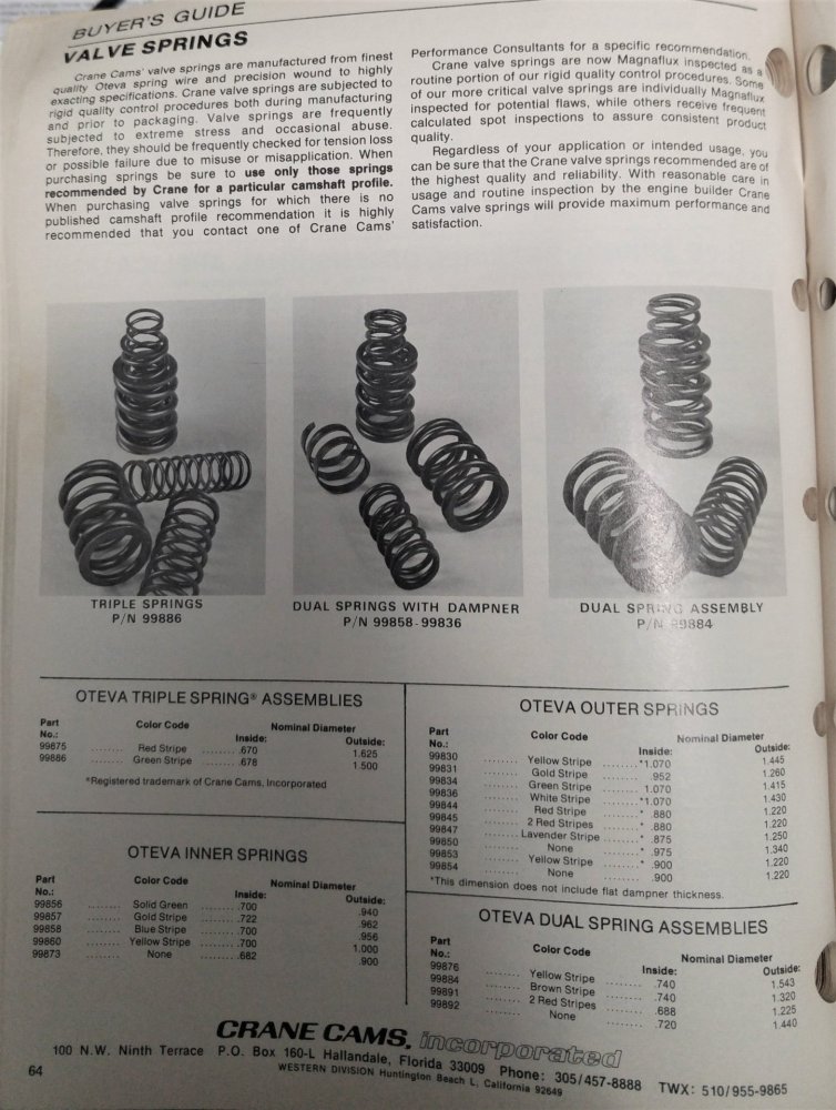

WTB for my project 4.0 OHV engine.
Got the retainers, found the smaller springs (99858), but cannot find anywhere in the internet the bigger ones 99834.
Alternatively I need specs of that springs, so I can find other vendor springs in catalog that would fit (maybe a bit stronger?)

Maybe someone has an old printed Crane Cams catalog to check what other engines these springs fit?
I'm more than sure these were not made only for Ford V6 engines xD

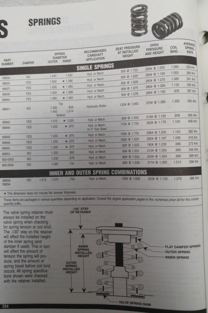

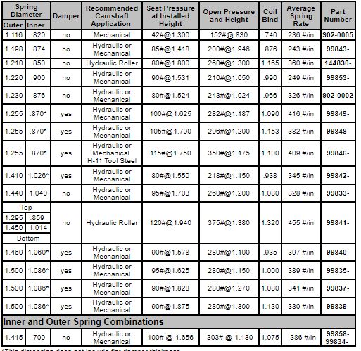

Found in the web some photos of old crane catalog. Still it lists these springs as "a set".
Seems I need to measure the tension of the 99858 springs I have and subtract that form the value of "the set" and that way find the required outer spring...
