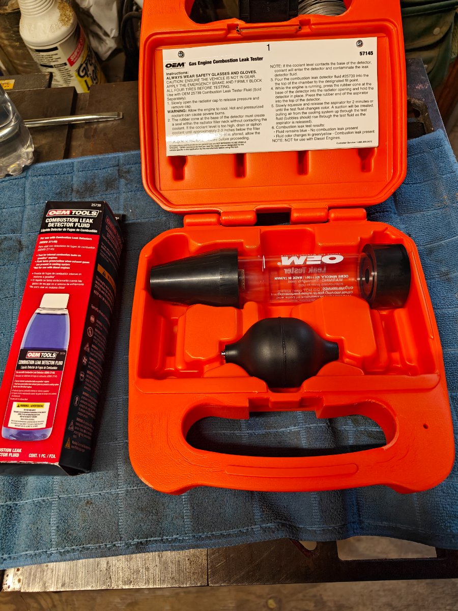

480k!?! On one engine? I guess I can see why fixing mine makes sense now. I used a coupon code for Auto Zone and got the tester and fluid for $30 shipped. Getting quite a collection of these OEM tools. Seem decent quality and come in nice cases.

My next used vehicle I'll bring my head gasket tester and check for recalls haha
