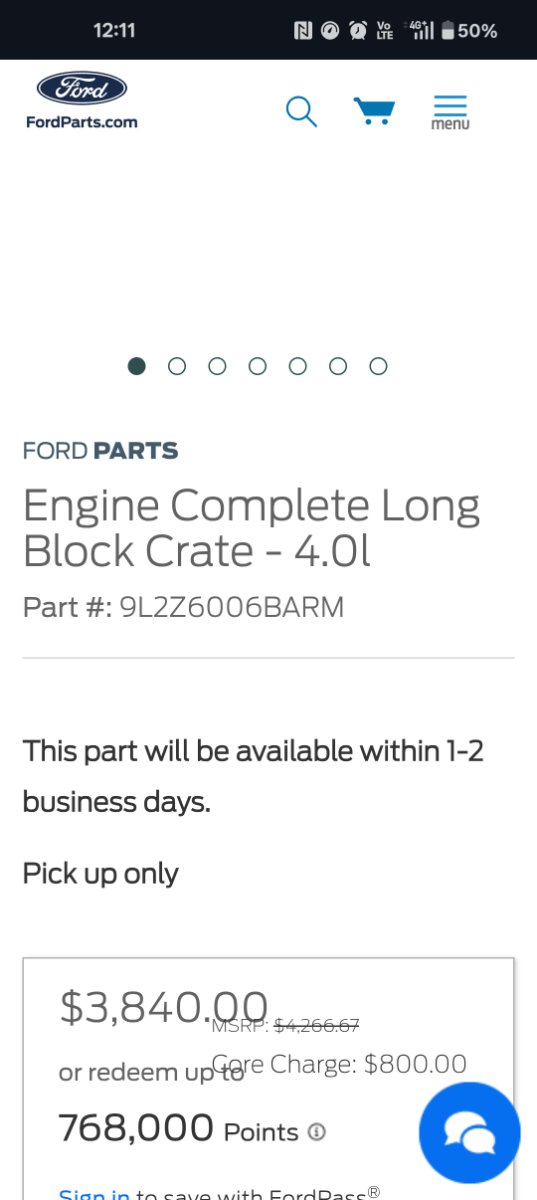

On Fords site it looks like they still sell them. I know the 4.0 was used in many vehicles. I'd be up for a factory remanufactured engine as well. I'll have to call them and see what they say...

This is what the Ford site says, whether it's true or not I'll have to see. But if they are available for $3800 (plus the core) I can't see paying almost as much for new head gaskets. Also the labor to swap engines but I'm fine with it.
I would confirm that's a NEW long block as opposed to a remanufactured long block. Most car companies sell both new and remans...someone else does the work and puts a Ford sticker on it. I had a $5000 GM reman transmission put in our service truck at work and it failed within 50k, 3 months out of warranty. Complete junk.

That's good to know but I'm not sure if it is reman because they have another listing for a reman long block but says they are on back order.
Thanks for the advice though because I was under the assumption that if I bought a reman from Ford that it would have been built by them to like new specs. If that's the case and they don't have brand new engines I might be better off having the heads and gaskets redone like you say.
You are right it is a reman. Going to call and ask them for a quote on head gaskets. Should I tell them to replace the heads or do they determine that when then they take mine off?
