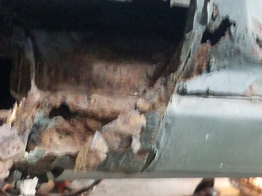

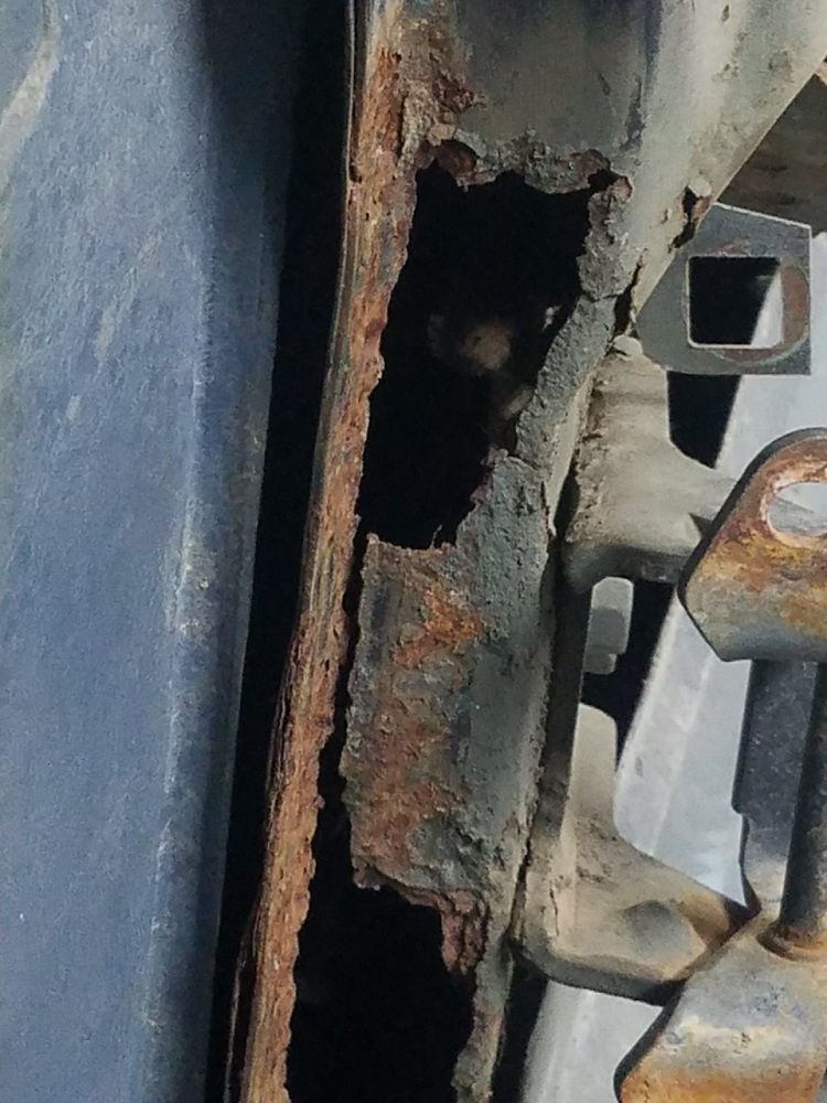

not sure if i fawked this up.

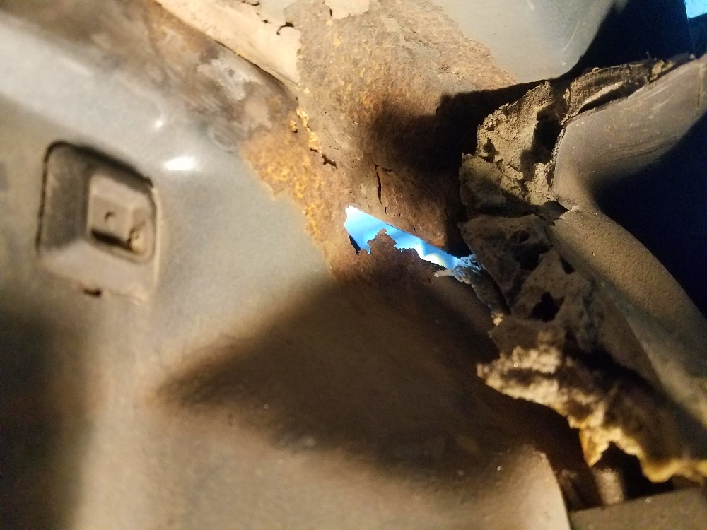

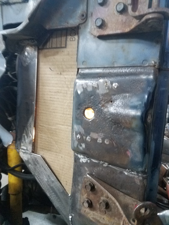

a pillar......upper passenger:shok: drivers side is completed now and total project is 2/3rd done. which is about 3 times the planned work...that "looked like needed doinz" running out of shitty sheet metal scrap though....
welding junk old sheet metal with flux core is a giant pia. if i wasnt laid off i would have spent 400 on gas and steel which would have knocked off allot of time and prep wheels. if i did not have a stock pile of shit i would have been screwed.
but this b2 did/does get whooped pretty bad.

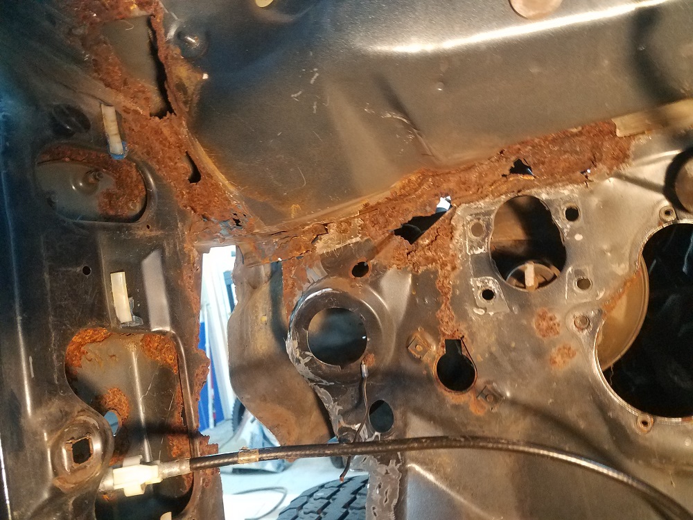

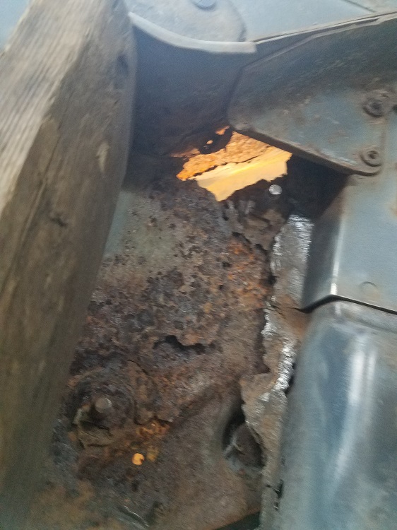

well...the point is it can/will look good on the outside..(firewall)..but rain all over inside.
with the fenders and dash/flooring shit on there its not possible to see whats up...

The floors wernt *that* wet even after the hellacious amounts of rain weve had in the past week, the cowl pan looks decent (what i could see), i was able to slide my hand between the fender and cab, and atleast the top felt solid.
There is some firewall rot thats obvious, the corners of the cowl under the hood, and around the heater box/heater hose entry to cab.
Whats odd though, is the carpet is wet, but the sound deadning shit inside the cab directly above the carpet is dry...
