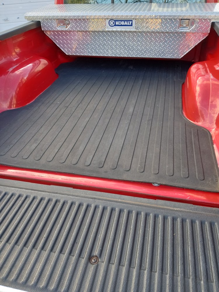

See tool box here. The dealer manager was like "tool box - $1,000 right there" and I was like "nah you can get them on ebay $50. I think they are somewhere in between. Haggling. I have to say in spite of that it causes some limitations, I really love the tool box. You can fit 2 gallon water jugs on each side/under it so I usually do that when going out. I don't know why they have it angled like that but it still has a ton of space in there.

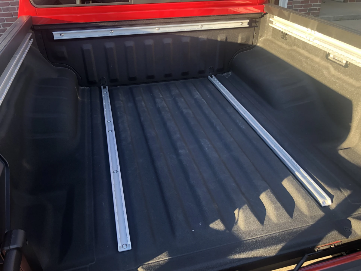

Heres what one guy did to his '22 Frontier.
Pretty cool! I might have put them further apart but he must have had his own reasons. Do you think he's using the existing bed bolts there?
It looks like the side ones are just thru the liner? That wouldn't be very sturdy maybe it was done differently but you can't have bolts sticking out the side of the truck.
That's that L-rail stuff like they use in air cargo securing it's really nice.

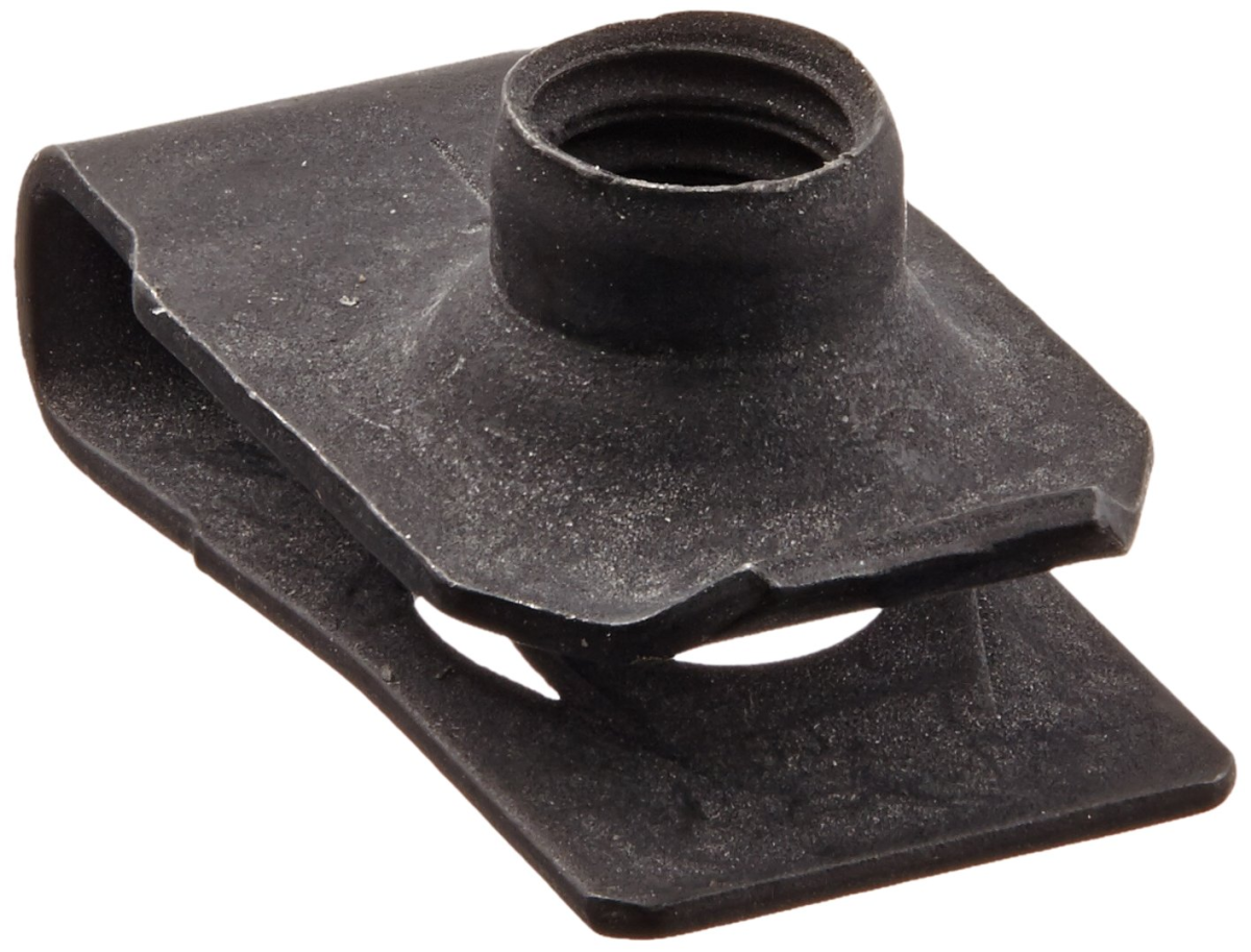

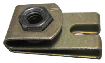

The bed bolts have a permanently mounted nut part, am I right about that? In other words if I take them out I won't have a loose nut falling down?
It's a nut fastened to a clip that slides over the edge of the frame rail. So, yes. The nut should not fall away when the bolt is removed. This, of course, varies with age and rustiness of the vehicle.
