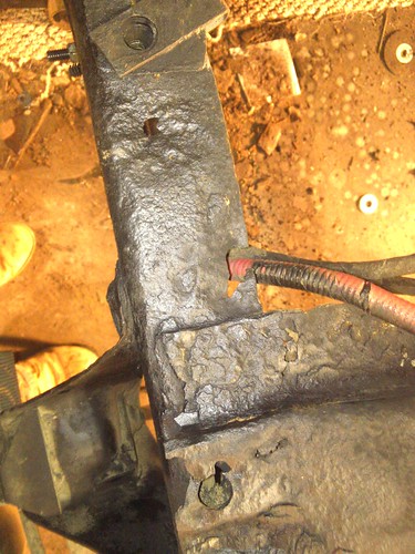

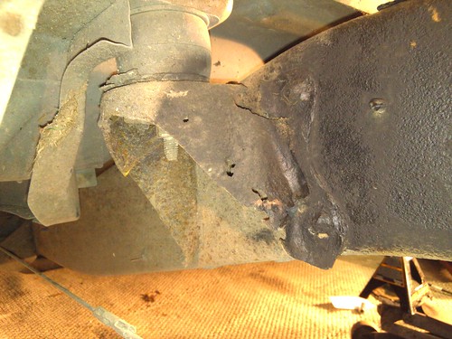

so my pretty ranger has some hidden cancer and im doing my best to remedy what i can but i think its just going to have to come down to getting rust free frame my question is Im looking for a decent frame i cant find one for a 94-97 ini any decent shape can i use an older frame since its still twin i beam?

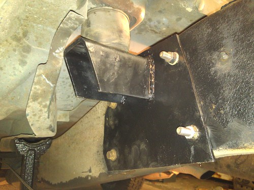

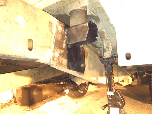

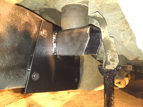

some of the remedies taken place

i believe the frame off of any ranger before 97 will work but not sure, i think the body mounts are different but it looks like u can weld. i will search around for u to see what i can find but someone else might chime in before i find anything.
ok so i did a little research on google and came up that yes u can as long as its a 2wd since between 90-93 they started welding the engine crossmember making it harder to swap 2wd stuff into a 4wd frame, but from what i can tell the frames are the same
I think that frame is in pretty decent shape, ive seen much worse than that

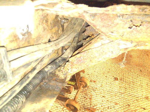

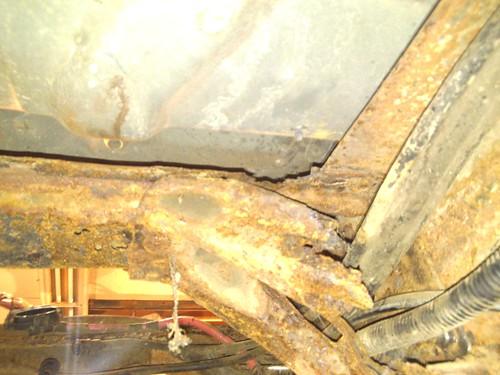

yeah the driverside body mount right behind it there are some holes developing in the upper channel of the frame. The cross member between the two rear cab mounts is absolutely shot. I dont really want to be welding patch panels all over the frame here and there like i did with the rear when i could just find a decent frame without rust and throw my truck on it. I am gong to try to stick with 90 and newer frame if i can just a better chance of no issues with it. then i can box in the rear section for strength and fab a couple stronger cross member in the front.
Nice work. My repair of the frame around the LF body mount is much cruder.. No welder, but lots of 3/8 bolts and a 30 X 6 " piece of 1/8 plate. Hand formed to fish plate the lower flange of the frame where it rotted away Beaucoup hammering . Fugly, but functional.

my driverside rear body mount was not even connected to the frame!:icon_surprised:

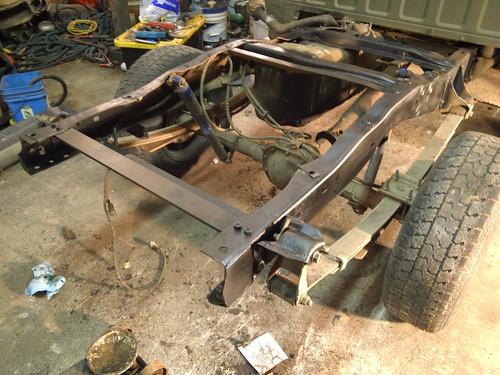

this truck is going to see some air time so it needs to be strong might as well start with a good new frame and box and reinforce it then slap it under the truck. :headbang:
Don't forget to show pics of your progress. You are going top have some serious time invested. I started fixing a bad transmission and ended up doing a frame up rebuild. Something addictive about working on these little trucks and as you do one thing you always see something else that needs to be looked at.

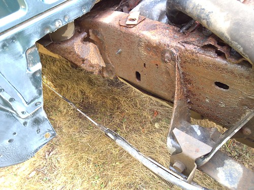

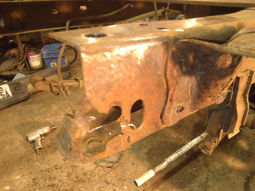

The lines running back in the pic are my fuel lines, brake lines and sending unit wires. and i wonder why i have a short in my fuel sending unit sensor so my gas gauge says its always full ha ha.

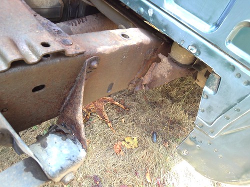

:shok: Cringed when I saw those pictures since my 94's not far behind. Still it's helpful to see where rust problems might develop next. Thanks for posting the pics.
Yeah look any where they powder coated crap. the spring hangers, the cab mounts around the gap where cab meets the truck and rain can down onto the frame. Thankfully my springs hangers are holding on but when i get a new frame its getting all new brackets and hangers and 64 inch springs 8.8 rear end. boxed frame fuel cell im getting rid of all the weak points
