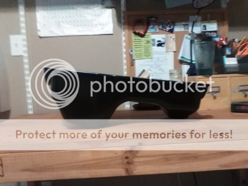

I also picked up this np205 off of craigslist, its seen better days and will need new yokes on both ends (they're cracked...), a new gasket/seal kit at least, paint, and a dual stick setup. Anyone got any advice on some dual sticks? I've seen some cable driven units and that seems like it'll probably be the best bet since this is totally custom. A foxbody dual sump oil pan is on the way and I'm planning on going with a 2 core fully aluminum "racing" radiator off ebay with a electric fan like this one:http://www.ebay.com/itm/2-ROW-ALUMI...fits=Model:Ranger&hash=item5d413b5a40&vxp=mtr
Any objections lol? I'm planning on buying the radiator and T-case parts on the 10th so I still have time to make a decision on this one.

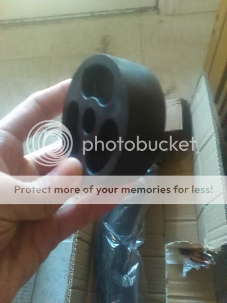

Just bought some 1" pucks from performance accessories. I figured the clearance will help big time, and I'm not a big fan of the gap associated with a 3" body lift so this works for me. Gonna paint the frame, replace my rusted core support, and replace the fuel filler neck in the meantime.
Picking up a 96 5.0 mounty tomorrow. 107k miles, awd, 3.73 8.8. Swap will be underway soon!
Parts that have come in recently:
Foxbody oil pan:
1" body lift pucks:
New fuel filler neck that I bought that's for a fleetside (about 1/4 the cost of flareside) but will be cut to fit:
The plan right now is to do the 8.8 swap and all that entails in the next few weeks on a "weekend" (my weekends are monday afternoons and tuesdays..) Any tips on that would be appreciated.
