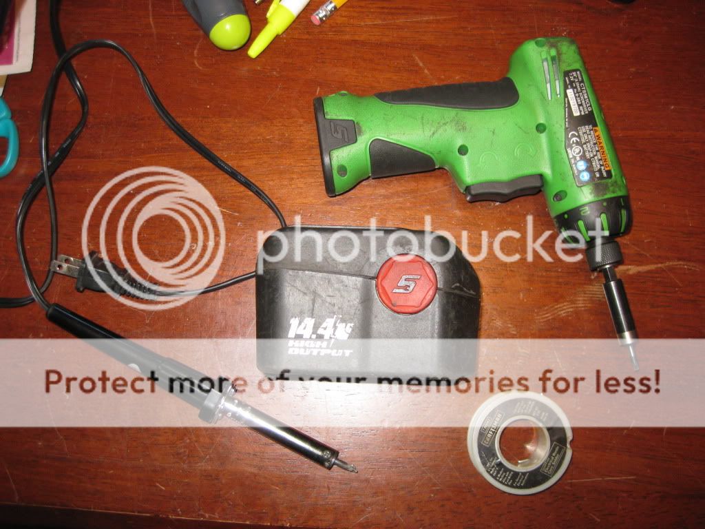

Tools Needed:
- Appropriate sized torx or screw driver
- Soldering iron
- Voltmeter
Parts Needed:
- Solder

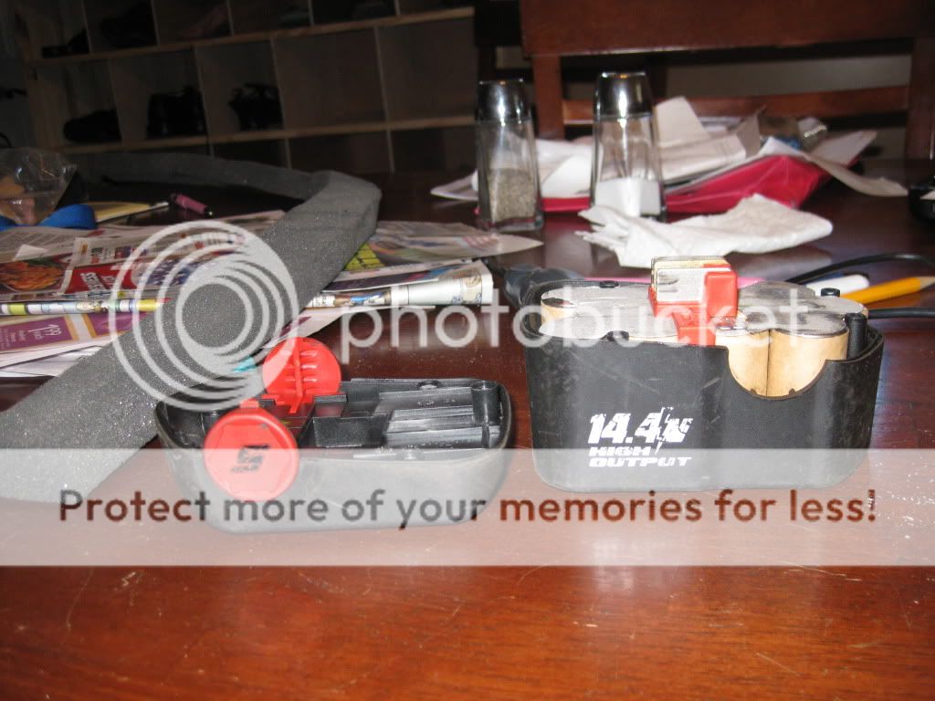

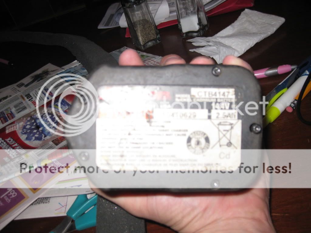

Steps 1: Open battery case. There is usually screw access from the bottom. The holes may be hidden under the sticker.

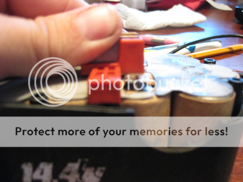

Steps 2: Identify the damage. This can be done by using a volt meter hooked to one tool terminal and the sides of the individual cells. Move from one to the other until you don’t read power.
In my case the solder points of the positive terminal had been damaged by the initial impact when I dropped the gun, and then broken completely by the vibrations of the tool.

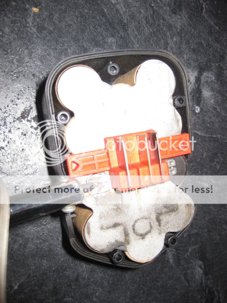

Steps 3: Solder the damaged connector back together. Given the safety issues involved in soldering directly on a battery I made a big solder booger and flung it onto the counter to make it flat. Then I pulled the terminal up, stuck the booger under it, and held the iron on the terminal until the solder melted.
I did not take pictures during that part of the process for safety reasons. This pic was taken with the iron cold and unplugged.
