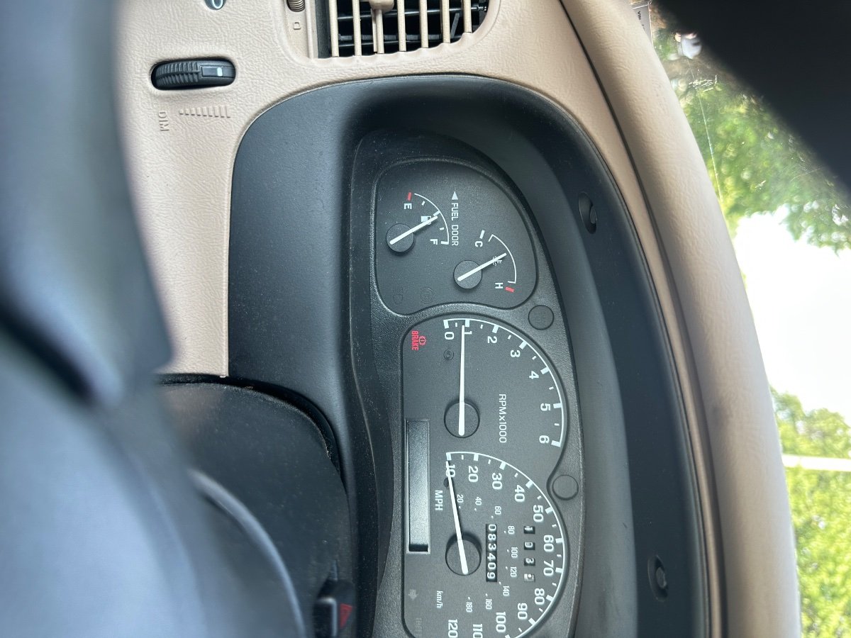

Upper rad hose was 178 at idle, the cylinder head temp is what it 220+
That's a different story. I have no idea what is normal in that situation. I've always just paid attention to coolant temp.
Dummy gauge is reading normal, but the OBD scanner pulls cylinder head temp since 01+ 2.3L rangers don’t have coolant temp sensors.
