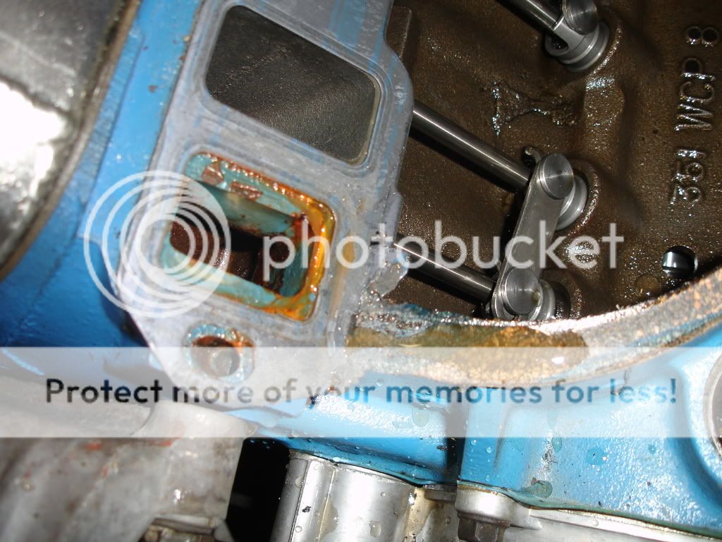

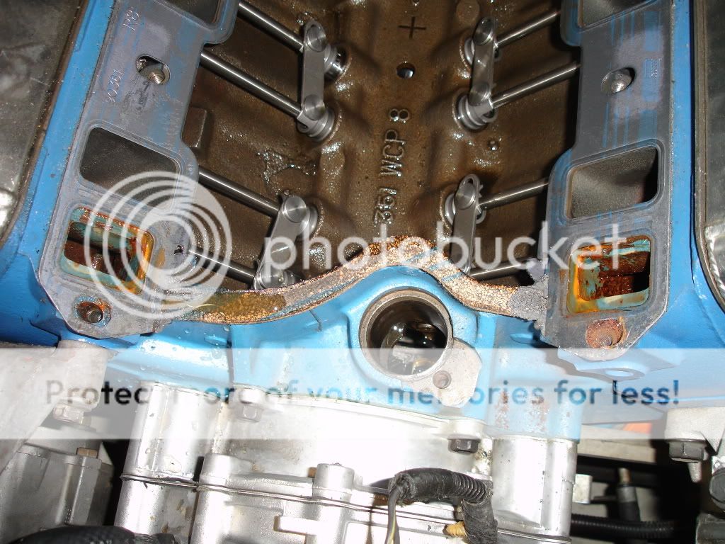

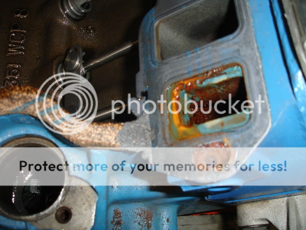

after reading this thread earlier i decided it was time for me to stop being lazy and go look at mine, heres a few pics of what i think has prolly happened to yours as well. my theory on mine is i over torqued the bolts and she didnt seal, the reason i think that is my cork gaskets are afu. i removed the distributor and there was water droplets on it, i then checked the oil, its about a full inch over full, point in case that the water will go straight down into the oil pan
Guide studs - old trick - works great - cut the heads off and slot them with a hacksaw in case they get tight. Throw away the cork gaskets and use a thick bead of High Temp RTV.
Guide Studs and RTV - that's the ticket.
