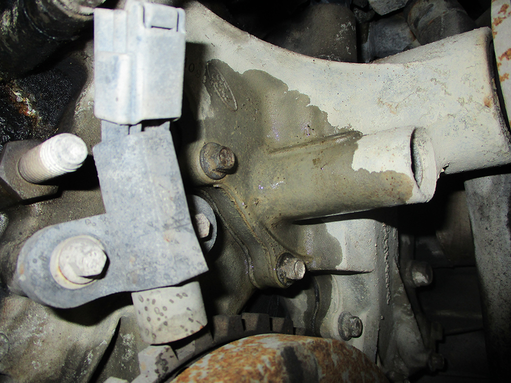

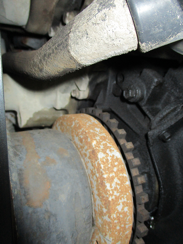

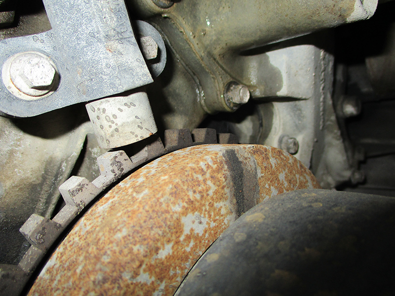

Hi all!
Usually I just drag my truck to my mechanic friend but he's not available... so I'm hoping someone here can help.
1999 Ranger , it's been sitting for a while due to parts needing replacing. Had some plastic t's go bad in the coolant system (one inch hoses on top), I couldn't get the clamps off, finally a friend helped. Found some ugly colored coolant so I recently did a flush/fill/flush/fill to clear it out. After about 5 rounds it's good looking, but then this morning it's dripping!
Attached are pictures of the area, behind the belt pulleys, that I think I narrowed it down to. The coolant being wet above the gasket looking area is baffling me...the engine has been off for over 24 hours so it's fresh. The leak is a drip every second or so (traveling down along engine parts).
I'm trying to identify what this area is and if I'm looking at major repair (in which case I'd probably end up selling the truck) or not so major (in which case I can wait till mechanic available). And can it be driven like this?
Chilton manual didn't help much !

Looks to me like the water pump. Which engine is this? Is the coolant fan blade attached and to the right of the first picture? If your cooling system had a bunch of mineral crud in there, then it’s possible that it was sealing the leak up on the inside and when you flushed it, it might have busted loose. I still think that flushing it was a good idea though, even if you now have a leak. At least you won’t be overheating because of a clogged line.

Yup, that thur is a warter pump.
Water Pump confirmed. Not a bad job to replace it. I did one in my 99 back in January. Took me waaaay longer than it should have because I had to fight to get my fan off but once you know the trick it's simple, I'd estimate that it would take 2-3 hours.

Ok, you guys convinced (scared) me enough to put a call into my usual mechanic. He said to wait until he can do it because he wants to do a "real" pressure test before we change anything. He smentioned that water pump is a total pita to change in this truck, no sense in wasting money and it being the wrong thing. He also said I'd have a hard time of it without knowing what I'm doing when I said I was thinking of doing it...

Update: Truck made it over to the mechanics house, I drove it early in the morning and blasted the heat the whole way-temp gauge rose but didn't overheat (whew). Of course when I got there it stopped leaking (probably due to more crud breaking loose).
While we were looking at the pump, I noticed my fan was cracking-cracks behind every blade and then one gaping crack behind one particular blade. Obviously I had him change that too-the one part no one had in stock locally so it was a good thing this isn't my daily driver. And due to the amount of antifreeze that had gotten on the belt, I had him change the belt (old one was 4 years old anyway) since it was coming off. Oh, and a new thermostat since I had bought one anyway.
He brought the truck back to me yesterday. He showed me the water pump-the amount of crud caked on it was incredible! He said he was surprised the impeller was intact still. He described the job to me, I'm very glad I didn't attempt it myself. Who designed this engine?!!? Different sized bolts, bolts needing special treatment, gasket that has to be removed but you can barely get to all the areas, moving the alternator and the a/c compressor over to reach stuff, sheesh! And yes he ended up using a chisel on the fan nut. EDIT: he mentioned in passing its a left handed thread and he held onto the belt to keep everything steady while removing it (in case anyone else didn't know that)./EDIT Of course this was 19 years of the bolts never being removed so that made it even more fun. The coolant he drained was yuck-all the draining and flushing I did only got out part of the crud apparently.
