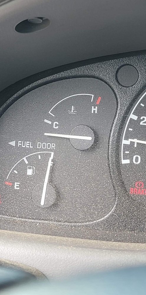

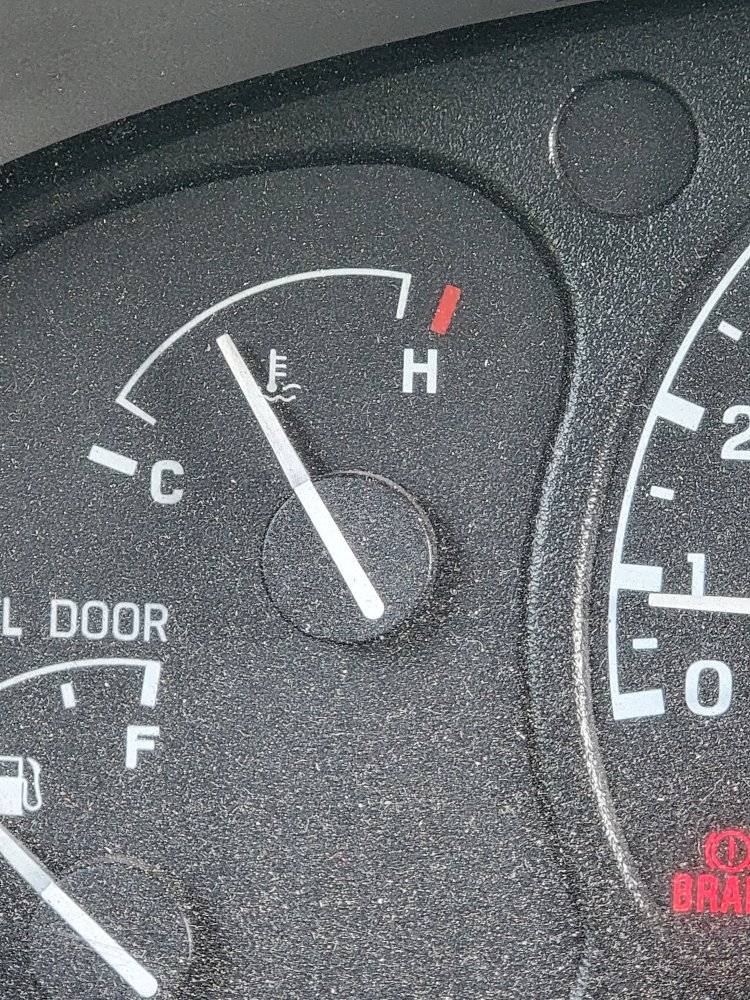

I've recently had my engine swapped and now have my truck back and the only thing I notice is that my coolant gauge sits under C but when the truck warms up its only goes up about a quarter above it. Just curious if this is a issue? Ive just swapped out the thermostat,sender and sensor. With no luck. I grounded the sender wire and it shoots to H. Maybe im just over worrying? Any input would be great.

Rangers all use a 190-195degF thermostat(since the early 1980's), except the 2001, and up, 2.3l which uses a lower radiator hose thermostat rated at 180degF
The gauge is calibrated for 210degF at 1/2 way point, so just below 1/2 would be correct needle position after 5 to 8min of driving time to full warm up
Also check the heater air, it should be HOT after full warm up, 190degF, not Luke warm, if not then its for sure a thermostat issue, not a gauge issue
Ok so it blows hot. The sender is only 1 wire.the truck its a 03 3.0 v6. The thermostat that was in there was a 180. I swapped to a 195 or 192 .
I have swapped what was in there sender and sensor to Motorcraft parts. I'm assuming all is left is to try to ground it send see if it works right . Appreciate the help!

I haven't gotten around to test it yet but I think I'm just going go leave it alone it seems to work I suppose.
That represents about 185-190degF on the gauge so correct after full warm up, 5 to 8 min of driving
Guess I was over worrying about it being past cold in that case. Appreciate the help.
