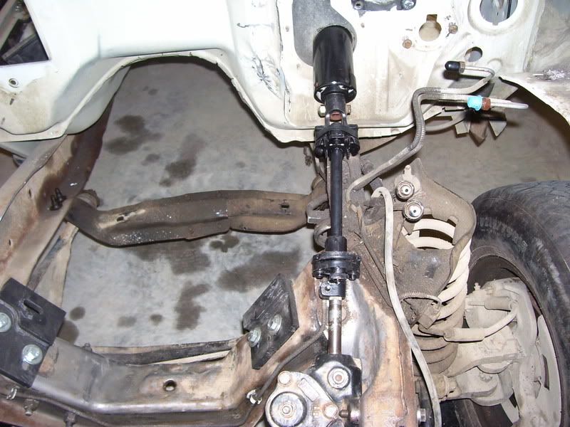

Hey if ya cant find anything at the junkyards the part # for the manual box for your truck is 27-5007 the brand is A1 Cardone most other brands use Cardone's parts and part #'s.
I am in the middle of the same thing (though for a different reason-- I am converting my Ranger to electric and don't want to waste the juice on running the power steering pump). I actually just purchased the Cardone 27-5007 manual steering gear box which does fit perfectly. I was very frustrated to find that the power steering pitman arm doesn't fit--what the hell is that about?!? Worst part is the manual steering pitman arm (E3TZ-3590-C) has been discontinued and does not appear to be for sale ANYWHERE. So, it is junkyard and forum searching time... if anyone has any good suggestions on where I can find one of these-- please let us know!

As noted, you also need to get the manual pitman arm, but I also found that I needed to get the steering shaft from the manual box as well. The splines of the steering box was different. Maybe it was just a year-to-year difference?
